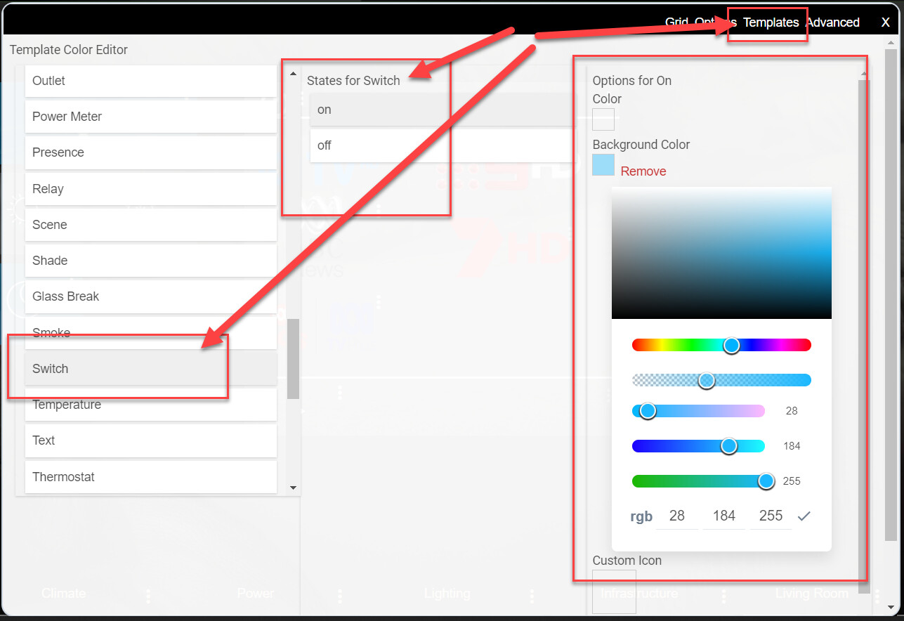

Colours can be changed through the Templates by clicking on the Cog icon, selecting Templates, selecting the Template you used for your tile(s), then adjusting the colour settings for that state. Replace my use of the Switch template in the screenshot below with the Template you have used for your tiles.
The text displayed will take a little more investigation, but should be possible...
