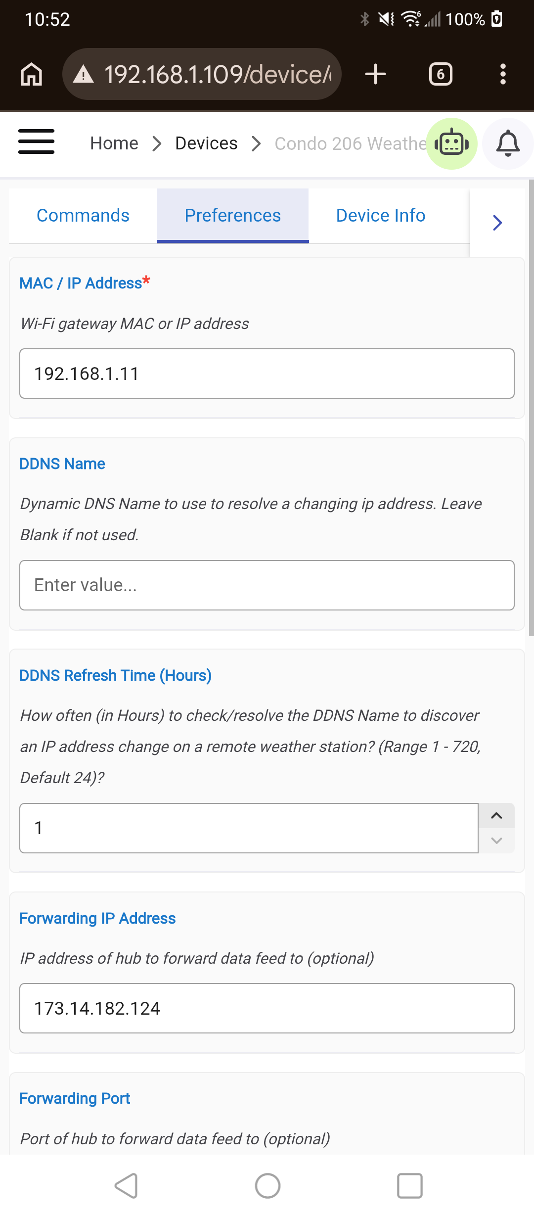

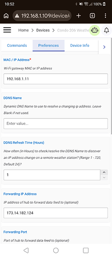

the ip or Mac address is wrong in the device on hubitat. here it must match your station ip. it probably changed and u should either update it or reserve the previous IP in your new router. .
thanks Kahan it seems to have fixed it.
Was just going to direct you to this in the main ecowitt thread. Same issue I think. The MAC shown on the Ecowitt app is for the WIRED connection. It actually has a different one for the wireless.
actually easier in that case to use IP instead of Mac.
thanks Tray
