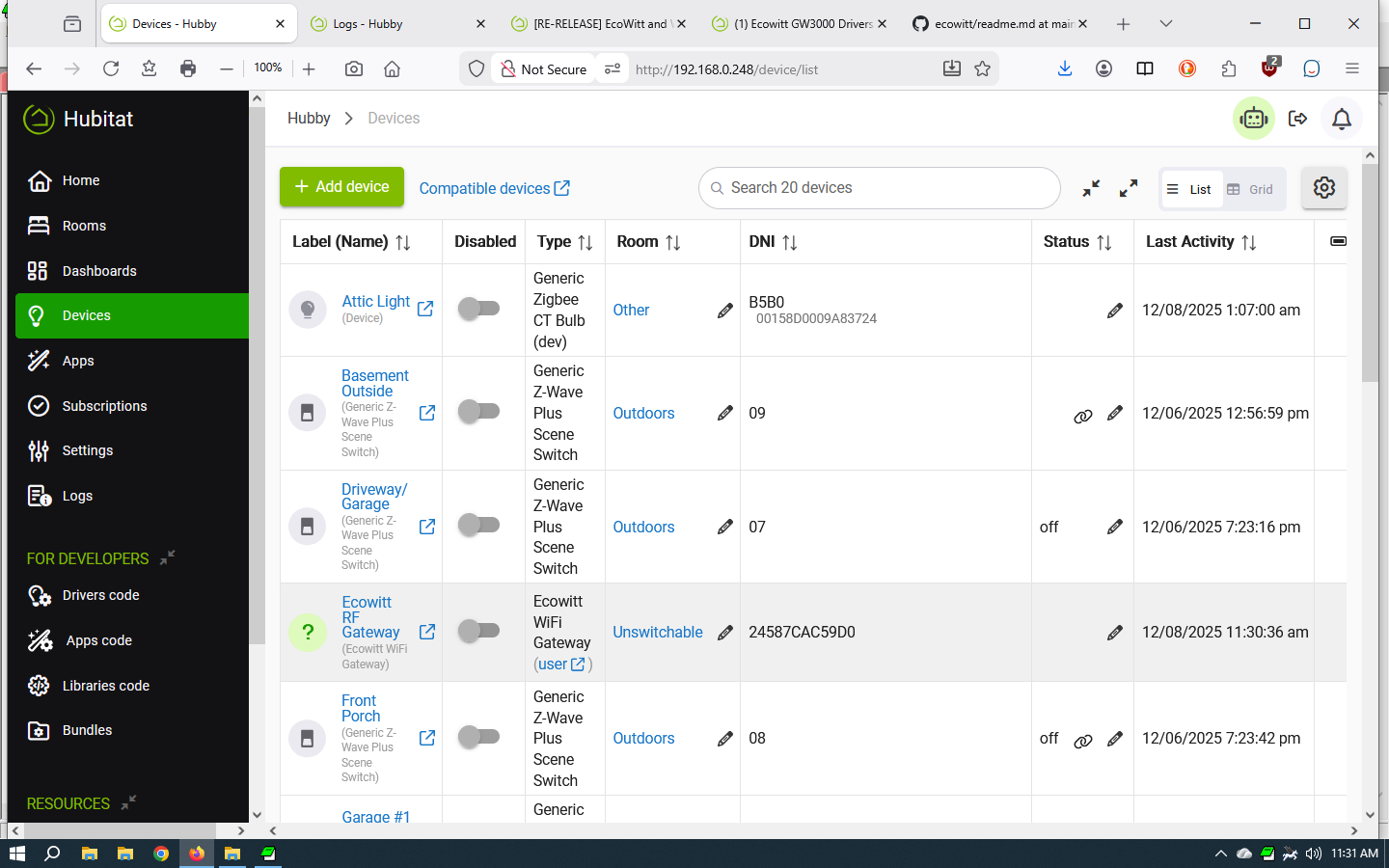

I have an Ecowitt GW1200 that is happy to communicate with my Android phone, and appears on my router. My C8P is connected to the same router. I followed all the install instructions as best I can, but the hub on the device list keeps showing up with a big "?". Here are some screen shots to show what I'm getting.

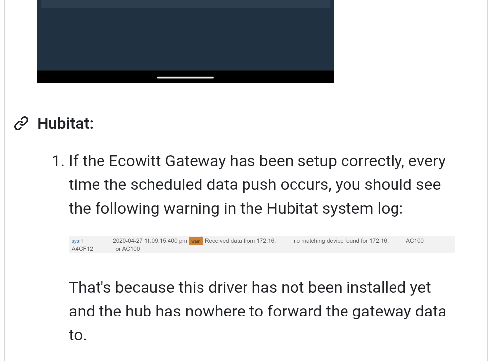

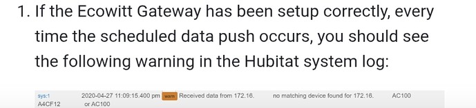

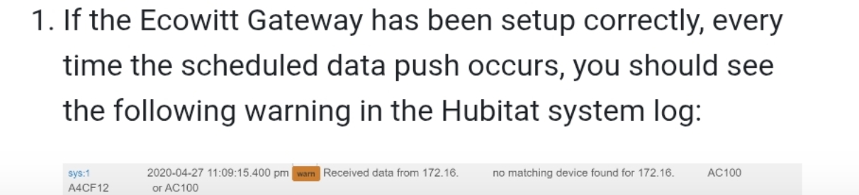

If you got to the step after you set up the push from the Ecowitt in WS View according to the readme file, did you get the syslog warning shown?
Syslog Warning
If so, does the MAC shown in the warning match the one you have in the preferences in the Hubitat device?
If not, you might need to revisit the part about setting up the Ecowitt to push to Hubitat.

If you look at the screen shot, you can see I used the MAC.
Indeed, and hence my suggestion to try the IP instead.
Oops, I misread you first post. I just tried it by IP with no change in results.
The MAC was the same, and then I switched to IP. Nothing changed.

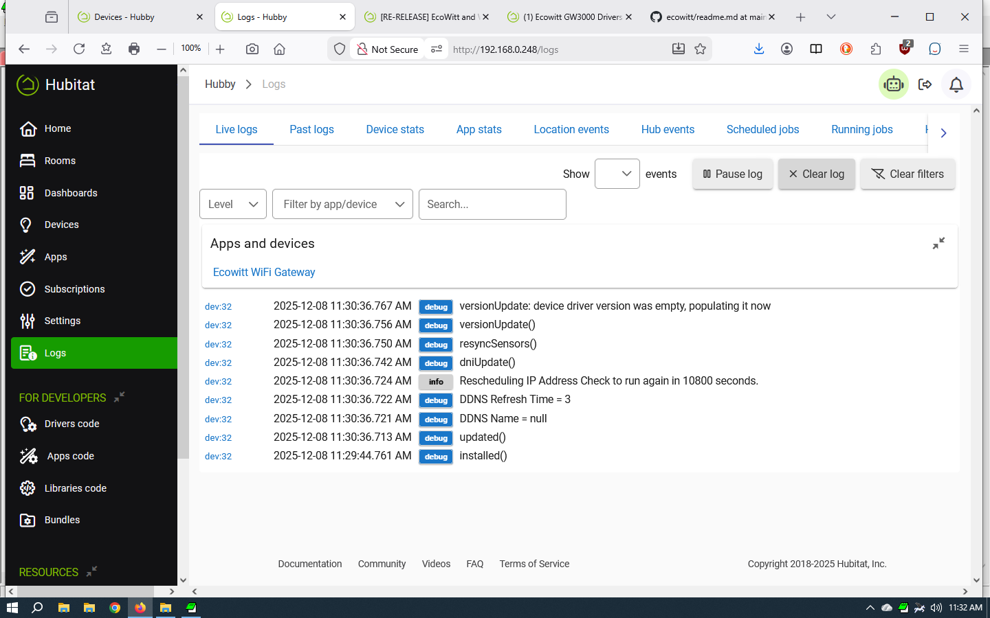

  8. I'm getting no messages in the logs.
If you are not getting messages in the logs, then something isn't right on the push side. Every 2 minutes, according to your settings (120 second interval), the ecowitt should be pushing data to HE. You would/should get warnings if that is happening and your app is not set up yet.
This was step one on the HE side. No message means no communication and you need to figure that out before moving on to setting up the app.

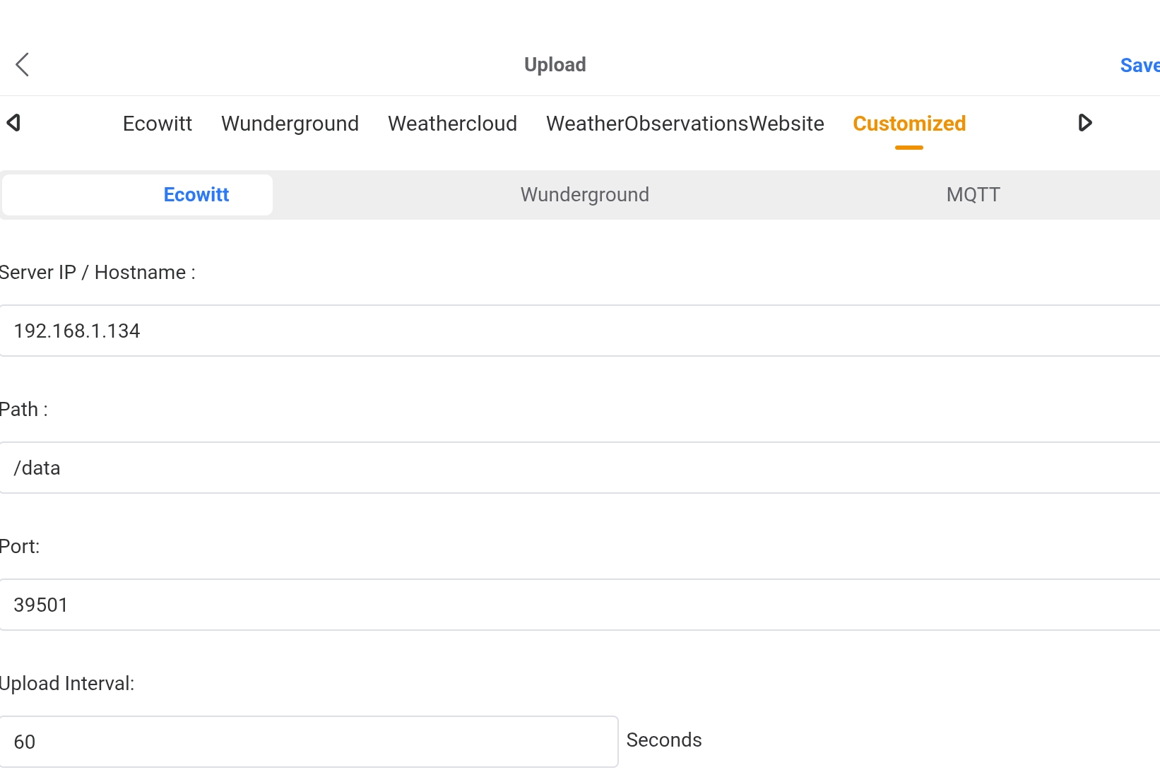

Screenshot of my setup. All IP's and ports are internal, so no need to mask. If you have slashes, or http:// in your IP (I think I did that the first time), then that will mess it up. Also, hubitat.local doesn't work on my LAN for most of my computers, so I used the actual reserved IP. Also, make sure that enabled is lit up. (Not sure you can enter data if it is not though)

In the phone app:
More -> Weather Services -> Scroll top menu right to "Customized" ->
Server: Your Hub IP
Path: /data
Port: 39501
Interval: Your choice, I use 60.
Just because you have not explicitly said yet that you have done this, I thought I should add the instructions. If you have done it, you can totally ignore this post. :grinning:
In my phone app it is:
...->Others->DIY Upload Servers->Customized
Then I have the rest matching what you posted, with interval set to 120.
