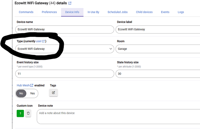

The gateway driver was correct, but I had changed the Type to Ecowitt RF Sensor because of the:
Received data from 192.168.1.35, no matching device found for 192.168.1.35, C0A80123:CE68, 38182BF0AE48 or C0A80123..
The graphic below shows the Type left at Ecowitt WiFi Gateway (originally, I had changed Type to the Ecowitt RF Sensor
