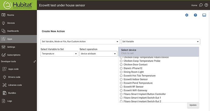

I am not sure what I am missing. I just added an Ecowitt multi-channel Thermo-Hygrometer sensor.
After resending the Ecowitt gateway device in Hubitat,it shows up correctly.
While I can use the device for either a trigger or a comparison in an app, it does not show up as a device for setting a variable.
Any suggestions?

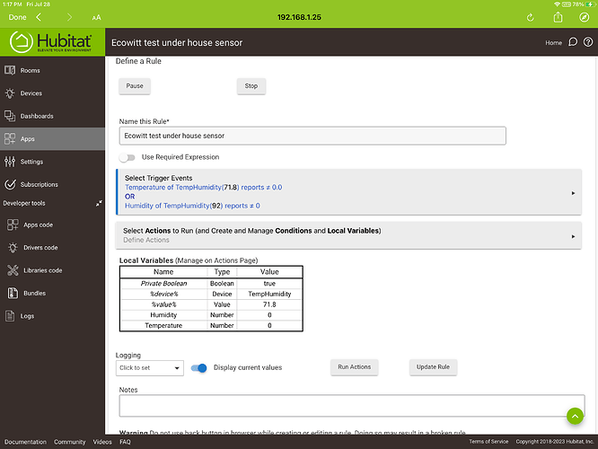

Can you show the setup of the variable?
You need to look for a device called TempHumidity from the list in your first screenshot.
(,My bad, the variable is not likely the issue)
Select Sensor Value, not Device Attribute. Also, just use Changed for the trigger, instead of not equal to zero.
Sensor value worked. Thanks…
