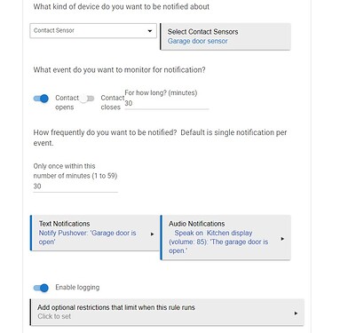

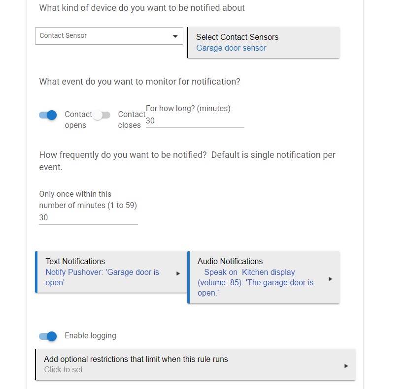

Curious on rules others have made for this. Thinking of having an announcement in the evening if open over tts/Alexa, repeat every hour if still open.
Easy to do using the built-in app Notifications.......
