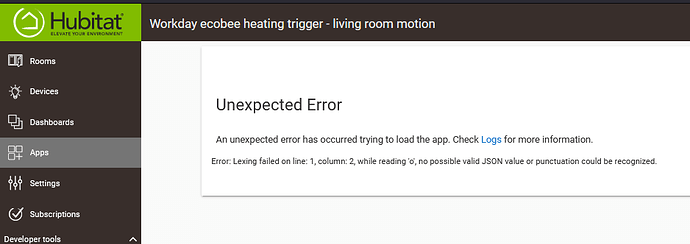

Why can I not access the basic rule itself on my local Hubitat that I created to control the Ecobee? This screenshot is what I see on the rule page itself when I try to access it.
The error in the log when I try to access the page is:
2022-12-23 05:54:54.234 PMerrorgroovy.json.JsonException: Lexing failed on line: 1, column: 2, while reading 'o', no possible valid JSON value or punctuation could be recognized. on line 1182 (method mainPage)
