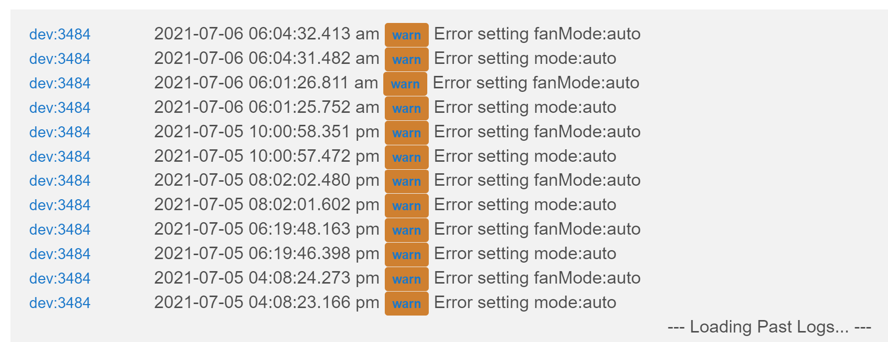

Hello all,

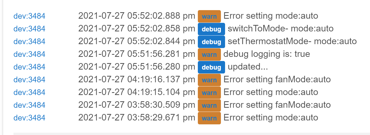

I'm using the built in Ecobee thermostat driver and have been seeing this error lately

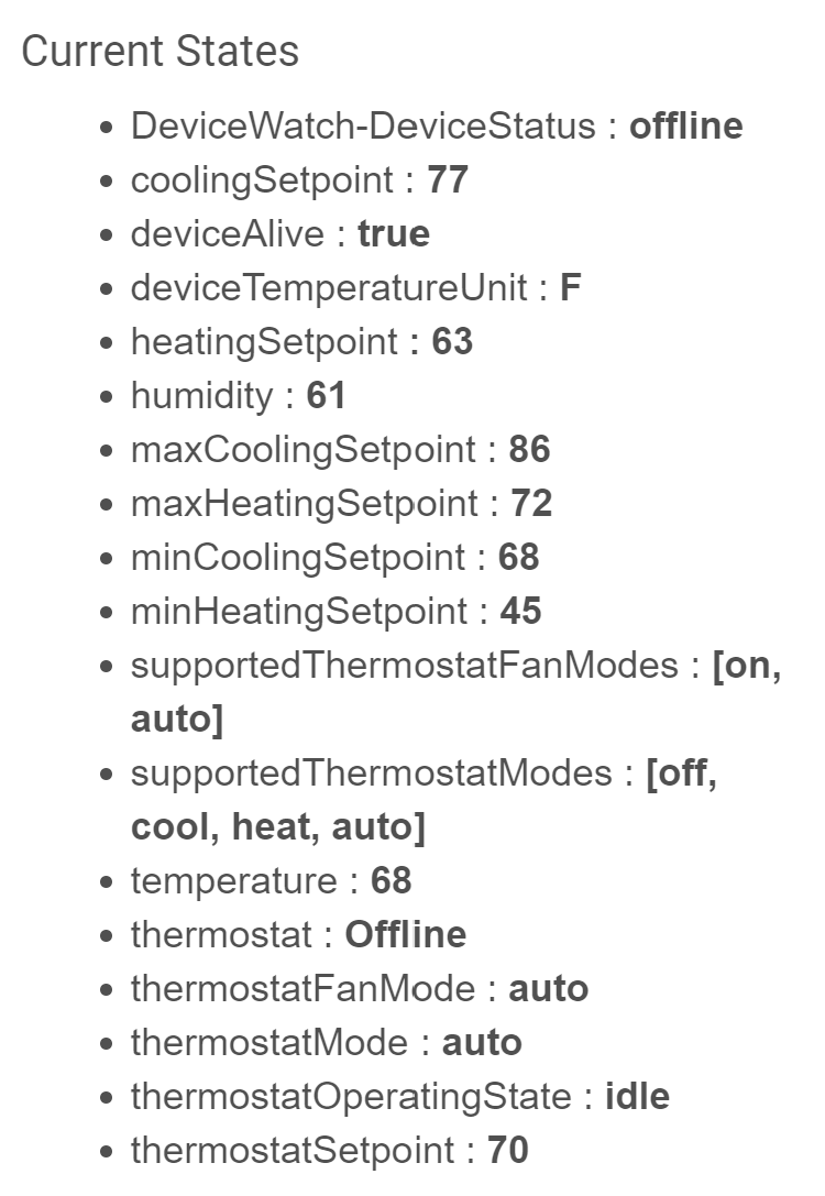

The device details seems to be fine

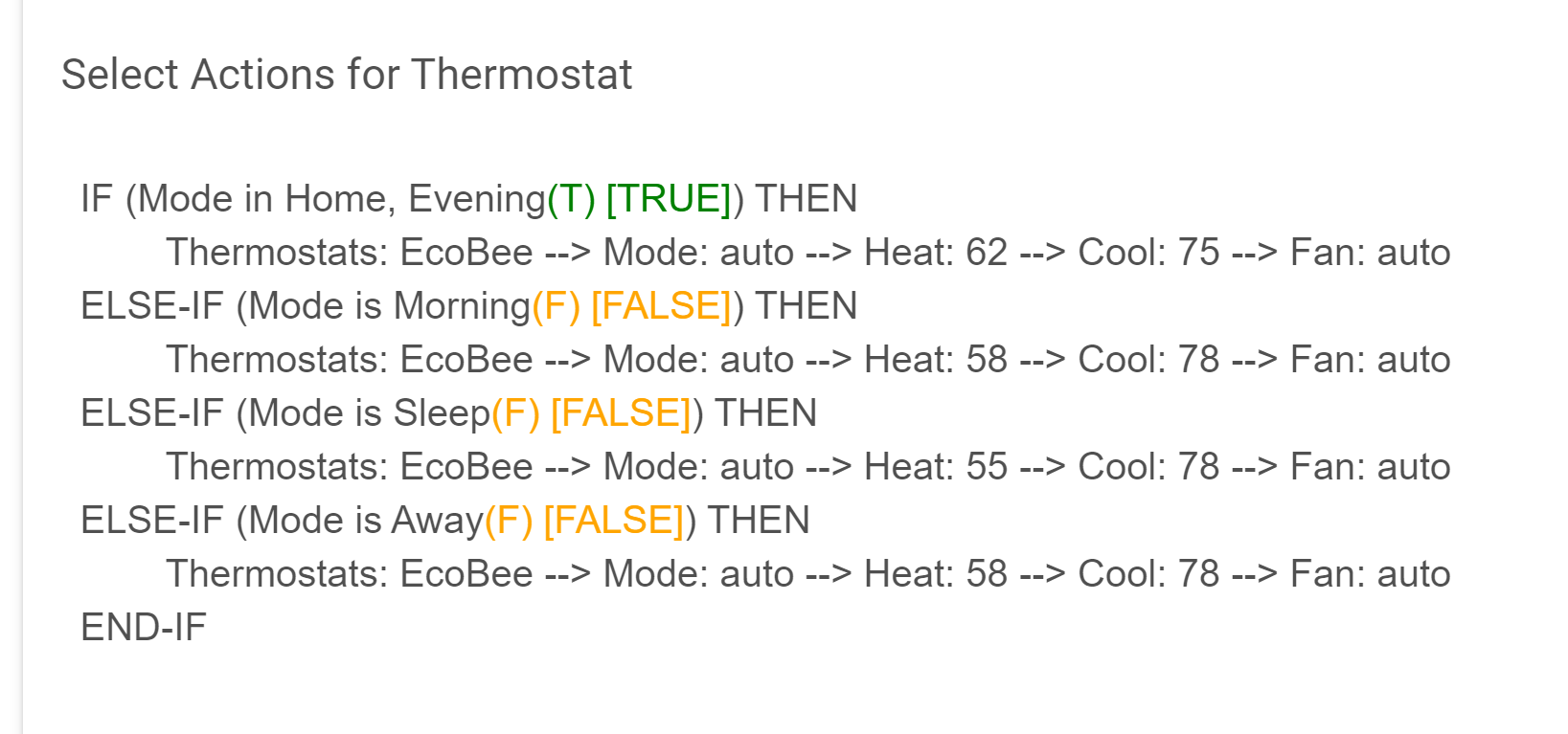

I'm using RM to set Ecobee based on mode changes
C-3 running 2.2.7.128
Any ideas what might be causing this error?
The error continues, any thoughts?

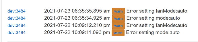

@mike.maxwell, still getting this error, turned on debug logging and nothing more to show
Are you able to change the mode and fan mode from the driver page?

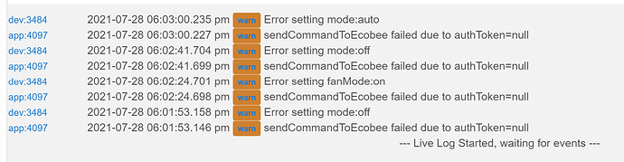

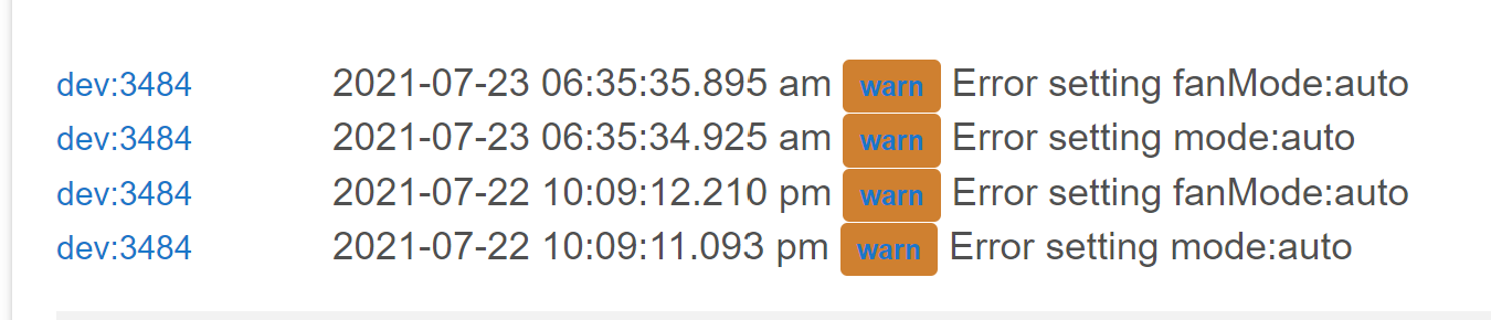

No Mike, not able to change either fan or mode, here is a current log
The Ecobee app wasn't logged into my account, so far, haven't seen any errors, let me keep testing
