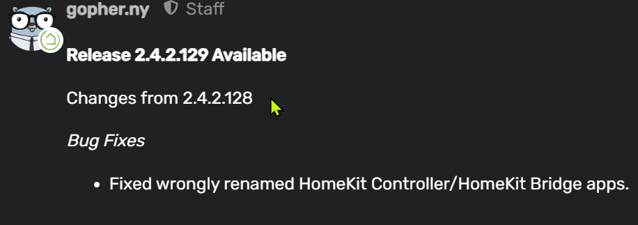

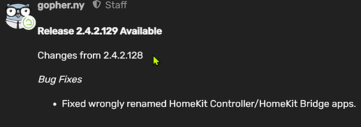

Release 2.4.2.128 Available
Ah...missed that.

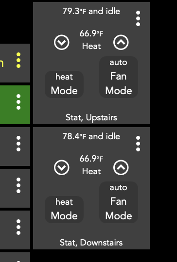

What's interesting is that changes in the dashboard are being reflected in the device page, perhaps after a refresh. I don't recall seeing that before. So now there's a 66.9 as a set point in the device page.
Yup - mine is doing that as well, and IIRC I think it was doing it on the previous release as well.
