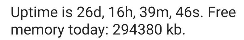

I use the Ecobee Suite app as well, but haven't had any severe hub load alerts. As of yesterday at noon my uptime and free memory were ...
