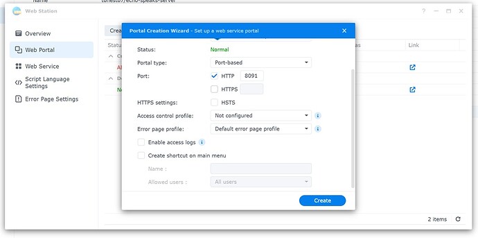

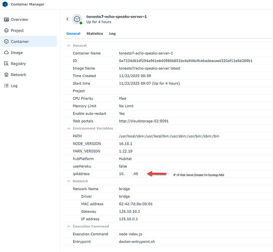

Docker Container Image

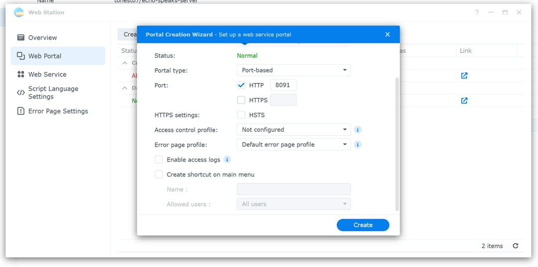

Docker Configuration Images:
Web Service Configuration Details:
Echo Speaks Install Images:

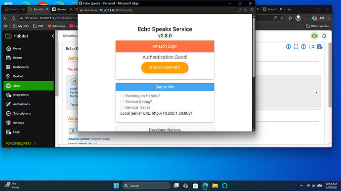

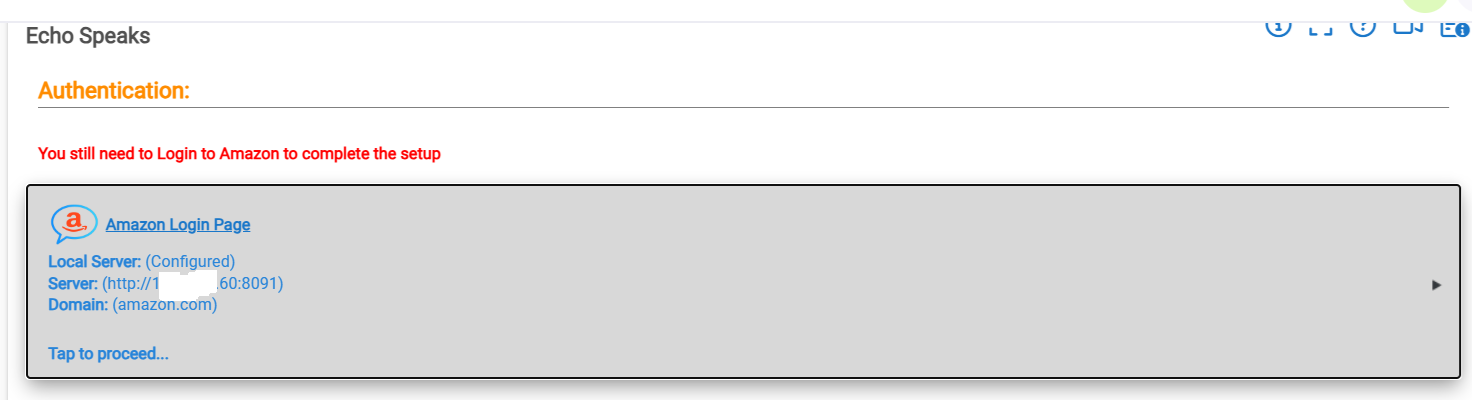

I am apparently logged into Amazon as I get the grey screen saying it got the cookie.
The it shows this:
But in the app it says
OK. This has been discussed recently within the various ES threads.
Try using an incognito/private window in a browser and from the ES app in Hubitat, go through the process of logging in via your ES server.
You may need to reset the cookie data completely within the app, if trying to simply login again doesn’t work.
