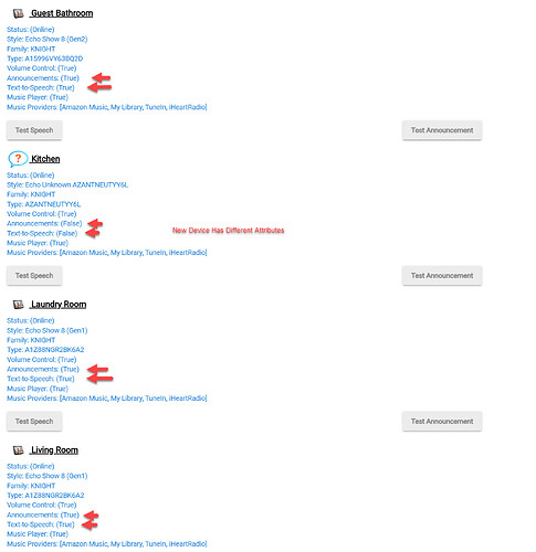

Recently replaced an Amazon echo 15" with a 21". Although Echo speaks recognizes it [see below] it will not communicate with it.
I think the issue is two device attributes [Announcements & Text-To-Speech]. All working devices have these attributes set to YES while this new device has the attributes set to NO. See below.
I already sold my 15" :-(. I don't know if purchasing another 15" will be a solution. Amazon may be setting this attribute on all new devices. I guess I can purchase one and return it if it does not work. Amazon needs to be more open with their devices if they want to sell more of them; although I am sure they are doing fine on their own.
Anyone purchased a 15" echo recently?
Anyway I wanted to let the group know in case they are considering a 21" and run into the same issue or if anyone has a workaround.

From what I have seen, new installations of EchoSpeaks do not work (or some of them do not work).
Again, it's an issue with the authentication of the Alexa device.
