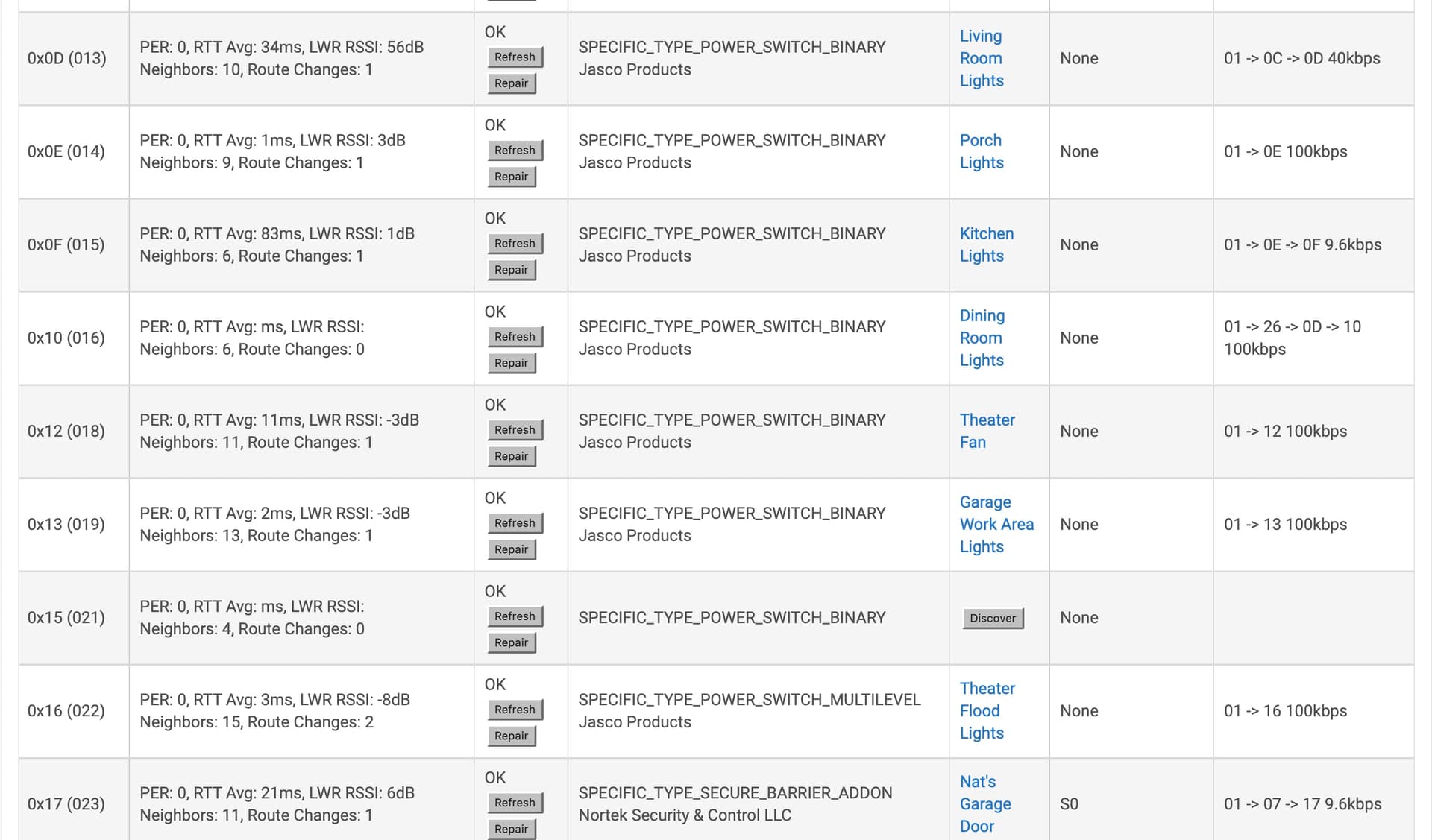

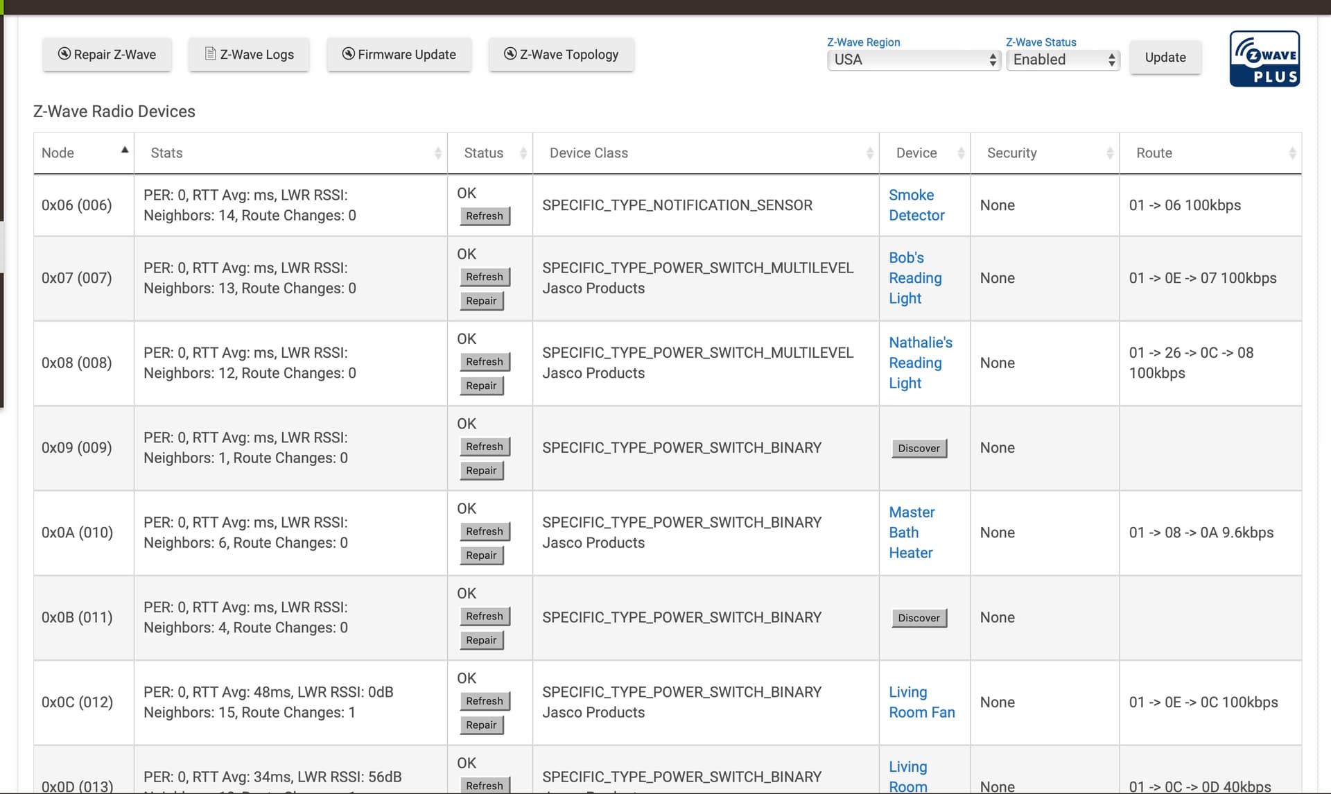

post you z-wave details page from hub settings

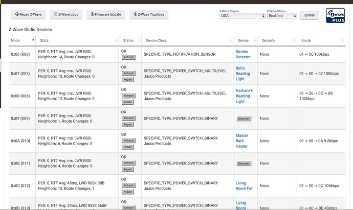

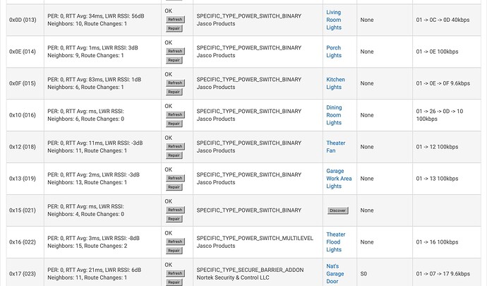

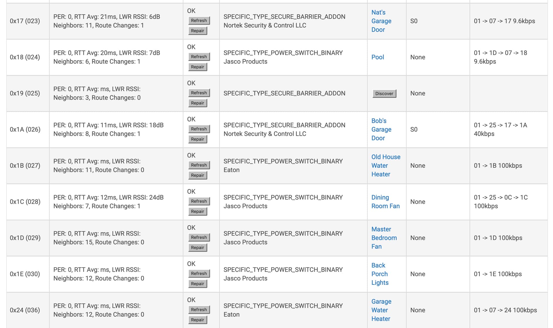

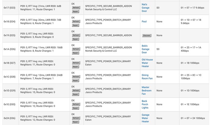

Based on his z-wave page on fb, @bob20 has at least 4 ghosts that need removed. That will prevent inclusion and mess up your mesh
Here are the screen shots. @rlithgow1 said to remove the ghosts. Working on that now. Just thought I'd keep this here updated as well for those who may not be on FaceBook.
I would recommend updating the z-wave radio firmware and then removing the ghosts.
I finally got it added but I have yet to get rid of the ghost devices. Any idea other than Amazon where I can pick up a USB Z Wave stick?
The smartest house. Either there or amazon you want the zooz 700 stick
