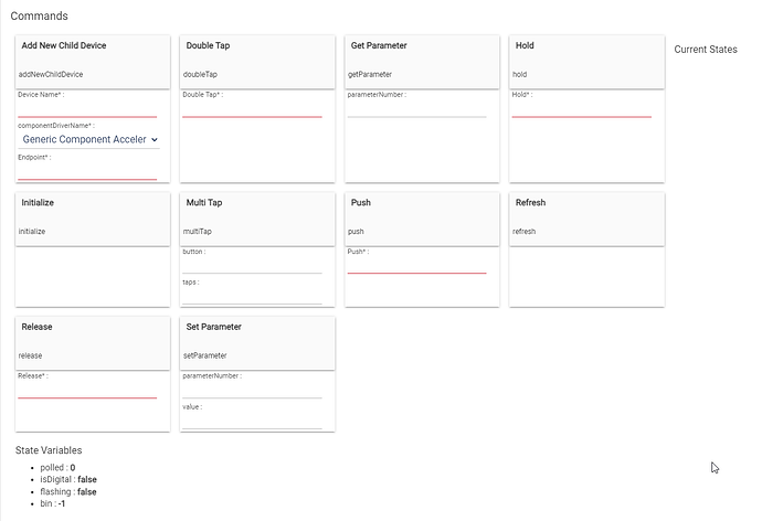

Thank you! How do I turn it on with this? lol I don't see an on/off after switching to the new driver.
The driver works in a parent-child relationship. The main body of the driver has code to handle almost any device type, but you don't control the device through the "parent". Control is through a "child" device.
So, first, click "Initialize" - now check if a child device was added (for many device types, they are added automatically). Then, if there isn't a child device, you can use the "Add New Child Device" in the upper-right corner. In your case, look for Generic Component Dimmer, or Generic Component CentralScene Dimmer. Endpoint is usually 1.
