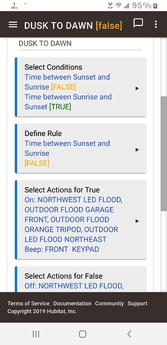

I have switches that were being controlled dusk ON, dawn OFF
It's been over a week since it last worked. The switches all work manually, and I can command them from the phone, but they don't go ON nor OFF by dusk/dawn.

Please share a screenshot of the automation which is controlling your lights. It is very hard to help troubleshoot without knowing how these lights are being controlled.
Hubitat offers "sunrise" and "sunset" and offsets to each. How are you calculating "Dusk" or am I being pedantic?
I think the screenshot of the Rule should provide the answer :smiley:
I hope I'm attaching correctly. I have not changed the rule in a couple of months. It worked about a week ago
I would remove the second Condition (i.e. Time between Sunrise and Sunset) as it seems completely redundant. The first Condition should cause the rule to fire once at Sunset and then again at Sunrise. At these two times, the Rule will be evaluated and will execute either the True or False set of Actions.

Curious...how are you testing it right now, when it is not exactly Sunset or Sunrise? Those are the only two times of the day when any action will occur (unless you run the rule manually.) It is hard to tell what version of the RM Rule you're using. It is definitely not RM 4, but it could be any of the version prior to RM 4. It would be better to have a full screen shot of the Rule, as well as its settings (click the gear icon on the Rule) to see what scheduled events it has.
