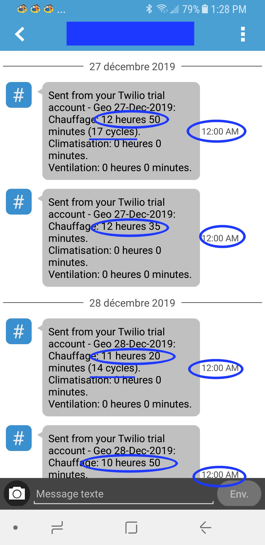

  • at 00:00 precise, I receive a summary message with the amount of time my geothermal unit worked: hours/minutes/heating cycles. Since 3 days, I received an (almost) duplicated message to my twilio, and the strangest thing there is that the global variables displayed on the message are different !
Msg1: heating 11h20 minutes (14 cycles), cooling 0h0 minutes, venting 0h0 minutes
Msg2: heating 10h50 minutes, cooling 0h0 minutes, venting 0h0 minutes
In the second message, received 1 sec after, the number of cycles is not displayed and contains a different global variable value ! Seems a ghost app to me (created probably at first but deleted).

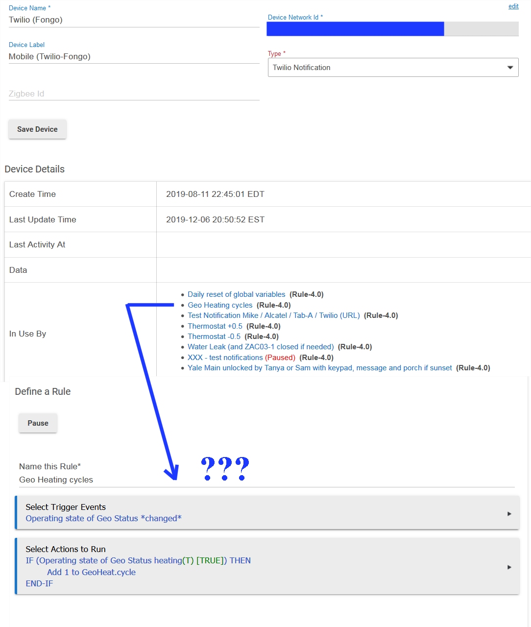

If I look at the rule itself, nothing strange.
If I look at the device, it shows linked rules but some rules that exists here are not using that device !

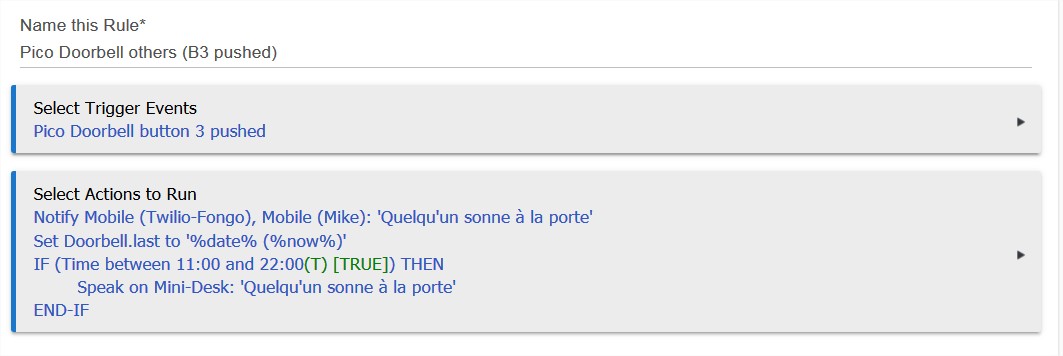

I shut off the second hub. Somebody rang my doorbell (my pico one) and I obtained 2 times a Google mini message ("someone is etc"). I double checked later and the problem is consistent. I added a twilio message to my rule and sometimes I receive one SMS, sometimes two :frowning:
Tried to change the message output: I swapped the message to another Google Mini, named Mini-kitchen. When the pico is activated, the message is spoken first on the (erased) Mini-desk, then on the Mini-kitchen !!!
Rebooted my hub. The problem is still there: even the app was changed (mini-desk => mini-kitchen), when the pico is activated, the message is said first using the mini-desk, then the mini-kitchen...
Changed another rule (doorbell for friends), based on the same initial rule. Changed the mini-desk to mini-kitchen and that rule has NO duplicated messages...
30 dec: Unplugged the "faulty" Google-mini (mini-desk), replugged, tested the doorbell... and the first message is no more spoken on that Google-Mini. Does it mean that the Google mini keeps old tracks in their memory ?
