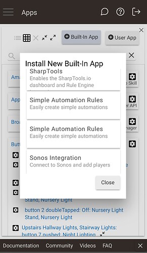

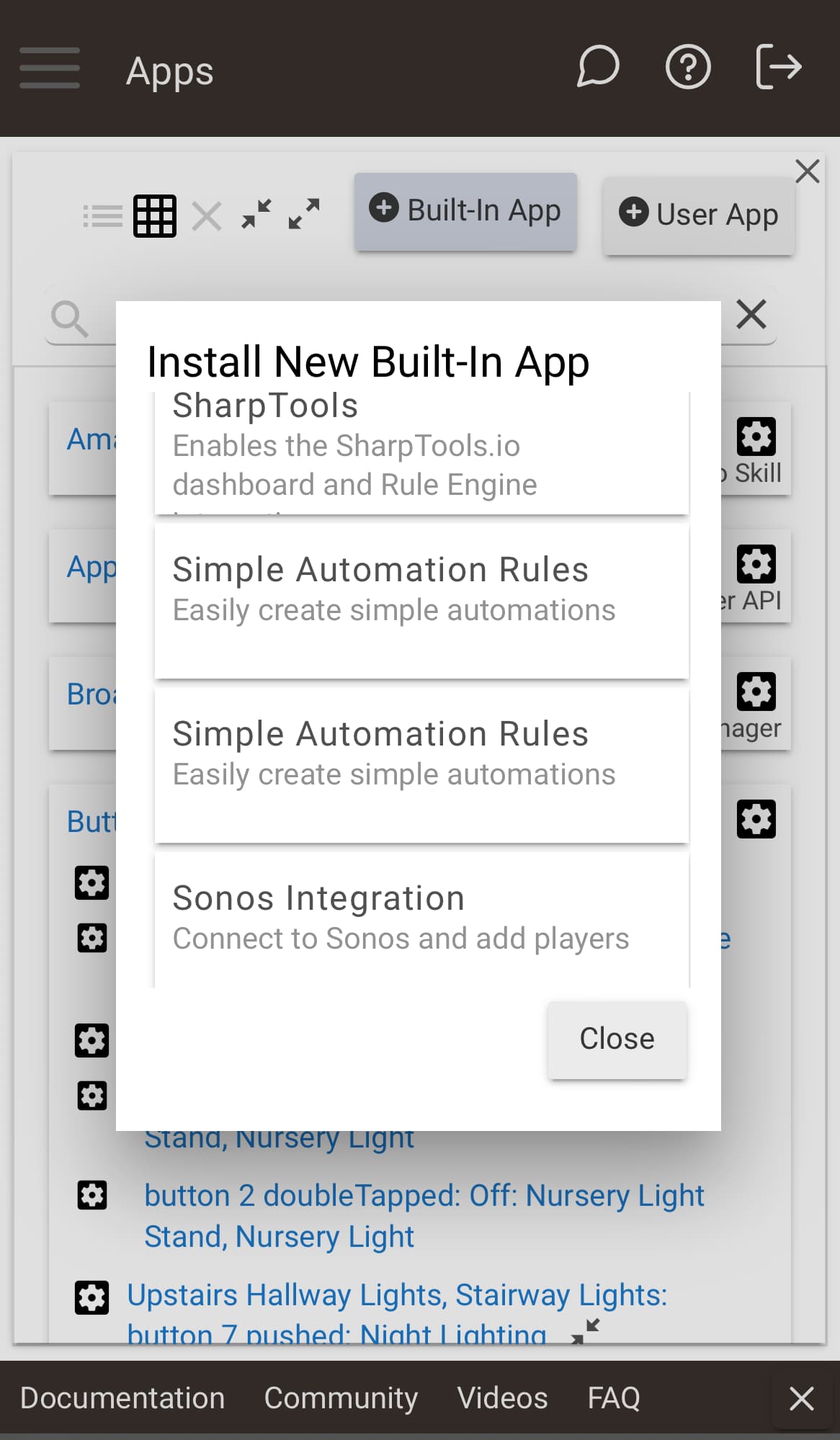

Duplicate Simple Automation App on C4
So I am trying to create a new Simple Automation Rule but it seems the app is showing twice on my C4 hub. When I go in to make a new rule, I get an error about versions. Both built-in apps seem to be the same..anyone know what I can do about this? Attached below are the screenshots of what I see:

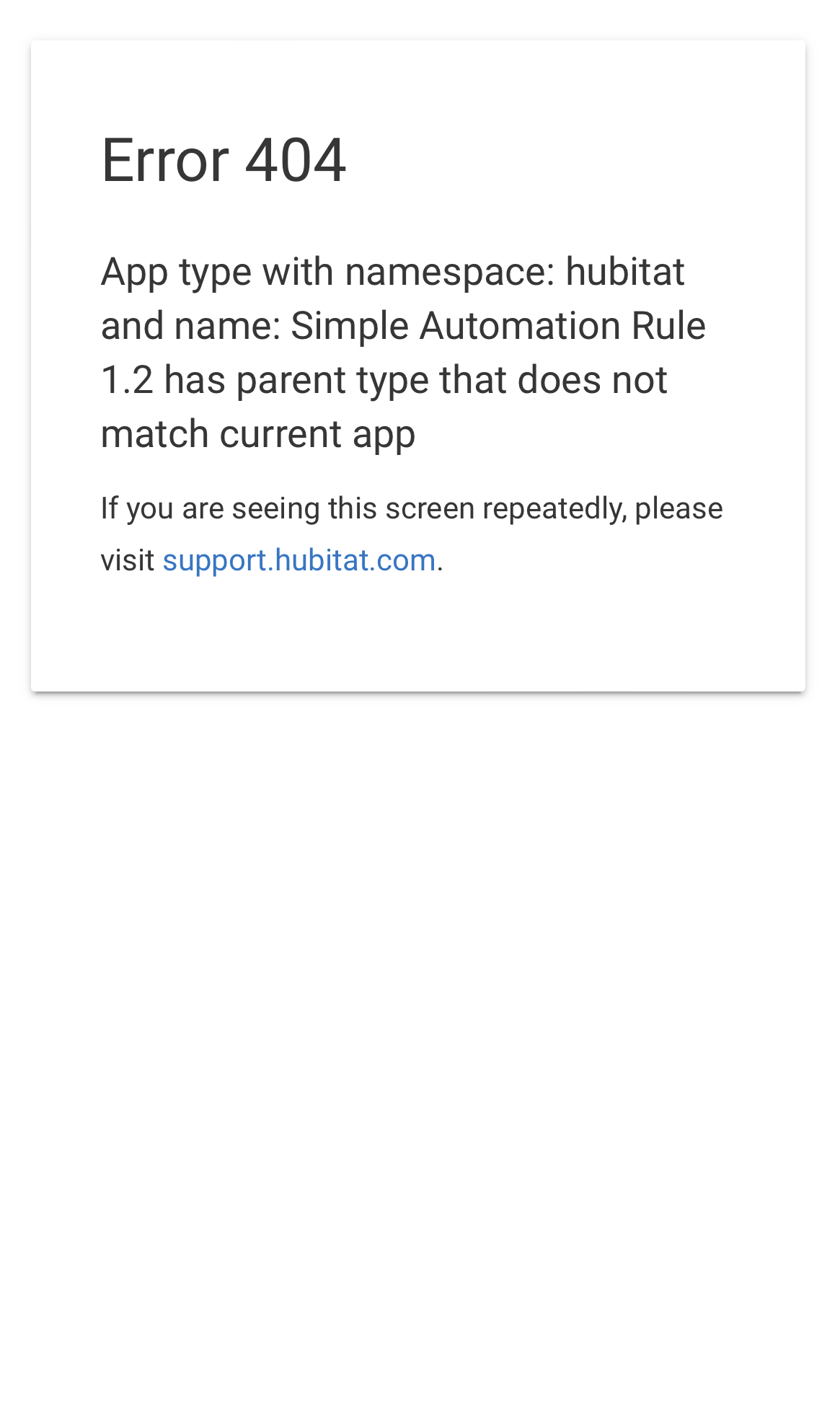

Can you go to http://hubs.ip.address.here/app/appTypeList and see if there is one of the two Simple Automation Rules apps with an option to delete next to it? If yes, please delete it. Sometimes, these get left over during updates, typically if a couple versions are skipped.
Hi, looks like I have quite a few...? Attached is what I see when I visit the URL. Do you want me to hit EVERY delete link for every app (not just the Simple Automation Rules/Rule)?
You can see some apps have similar names such as Simple Automation Rule 1.2 vs Simple Automation Rule vs Simple Automation Rules...

No, they will get recreated upon reboot anyway. Just delete the ones that give trouble.
Thanks, look like it's resolved.
So just to be sure, I can do some cleanup and remove the other apps as well if they have a 'DELETE' link next to them? No harm no foul other than my OCD calming down?
They'll come right back on reboot. These are not app instances, they are app types.
