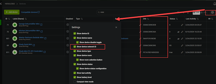

Separate to that detail.... (If you are using the more recent platform releases...) To see the DNI you can either get this from the individual device pages or by choosing to have this displayed on the Devices page:
Thanks I found it. Turned out I thought I had looked at all the devices but had one disabled and it happened to be the duplicate. Getting used to the new GUI has been challenging.
Also thanks for the heads up on the
Show device network ID in settings.
