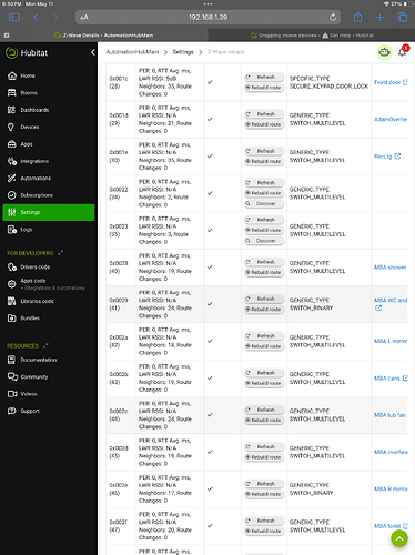

Post a screenshot, it may take multiple screenshots, of your Z-Wave details screen under settings. Make sure it's a screenshot Don't try and just copy the text and paste the text.

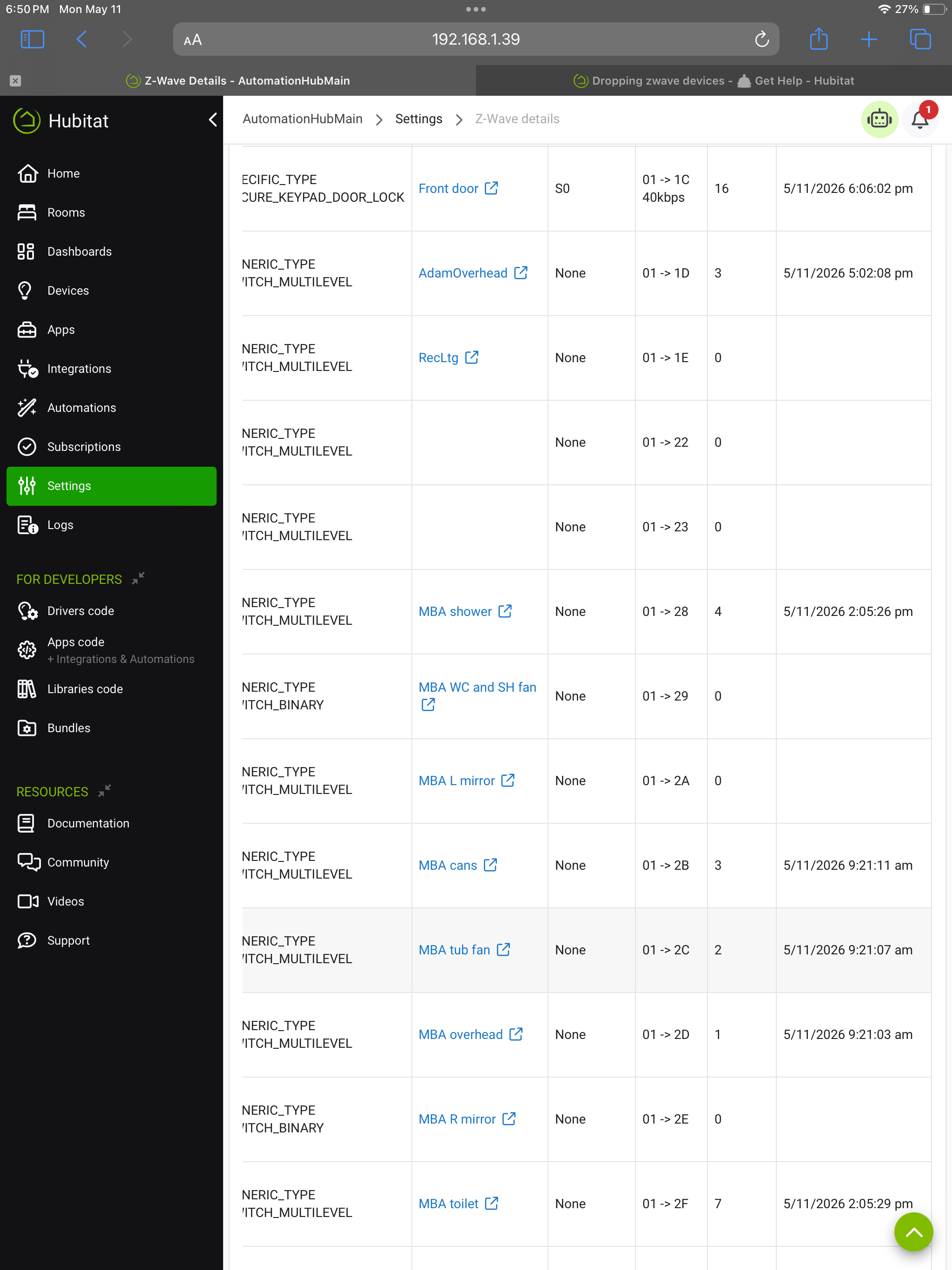

I had said C8, but here is the other data. Top,line is the current unresponsive one.
There’s at least a couple Z-wave ghosts that need to be removed.
I think I see what you are talking about, but don’t see a way to remove.
@danabw would be the appropriate person to guide you here because he's written a detailed guide on ghost removal. On a C-8 Pro, the process is made simple by switching to ZWaveJS. However that option may not be available on C-8 hubs.

Zwave devices never "drop" from the network, it is not possible unless the device is factory reset or the device itself is faulty. They retain the network ID and will keep sending messages to that network ID until they are excluded or factory reset.

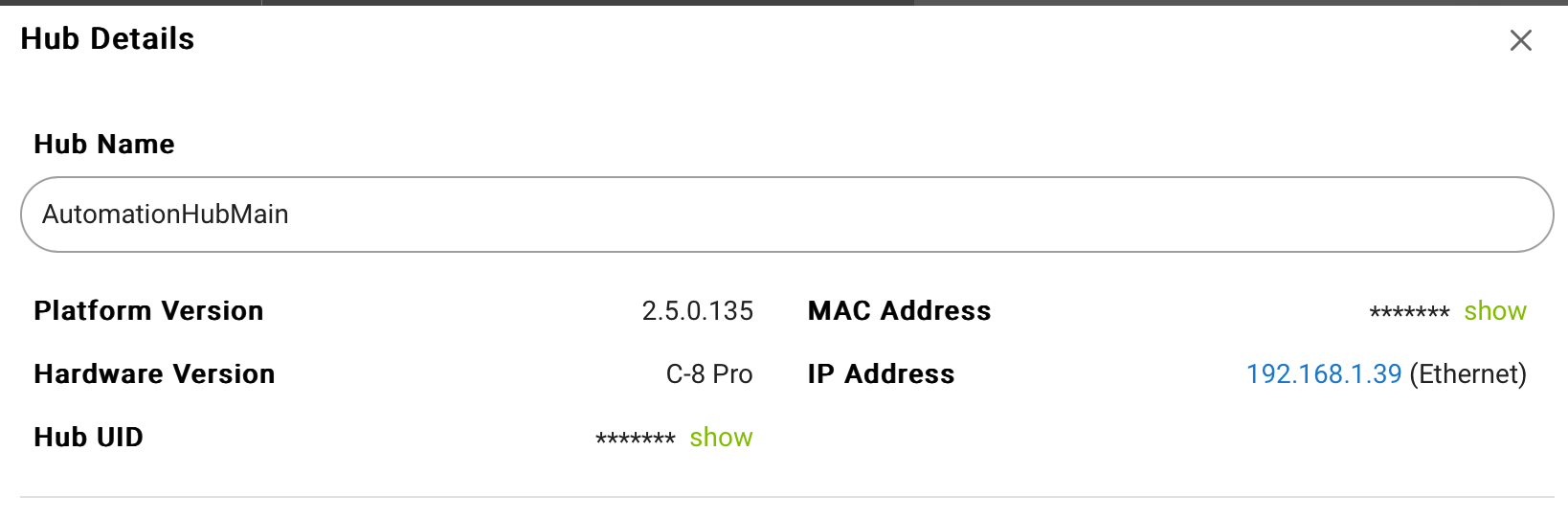

Also you have a C8-Pro I see, are you running the Zwave JS gateway or legacy ZIP? You can tell based on the "switch" button on the zwave details. Based on your Route Changes showing a number and not N/A it looks like you are probably on Legacy.
Also, FYI, when you post the zwave details you need to click the refresh details button first, wait a few seconds, and refresh the page. Otherwise the stats are useless. This is covered in the "READ FIRST" post.

I'm using the legacy zip. I refreshed details and then the page:

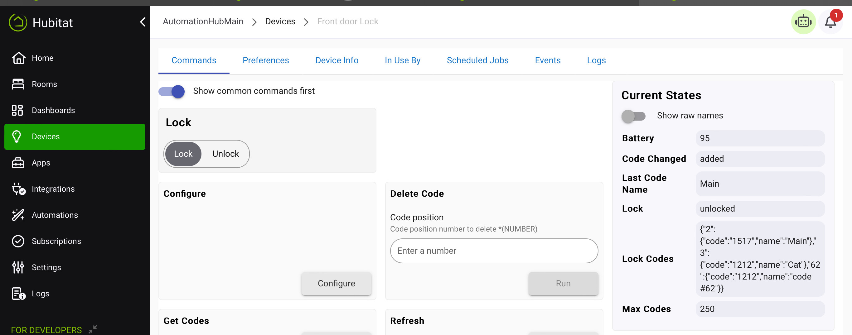

The red Icon I'm referring to is on the Devices tab:
Glad most of your devices are back. Remove the battery pack from the lock, wait two minutes, and power it back up again. Make sure the batteries are good (>1.45 VDC each).
Red means unlocked, like green indicates locked. That does not indicate lock health or communication health.

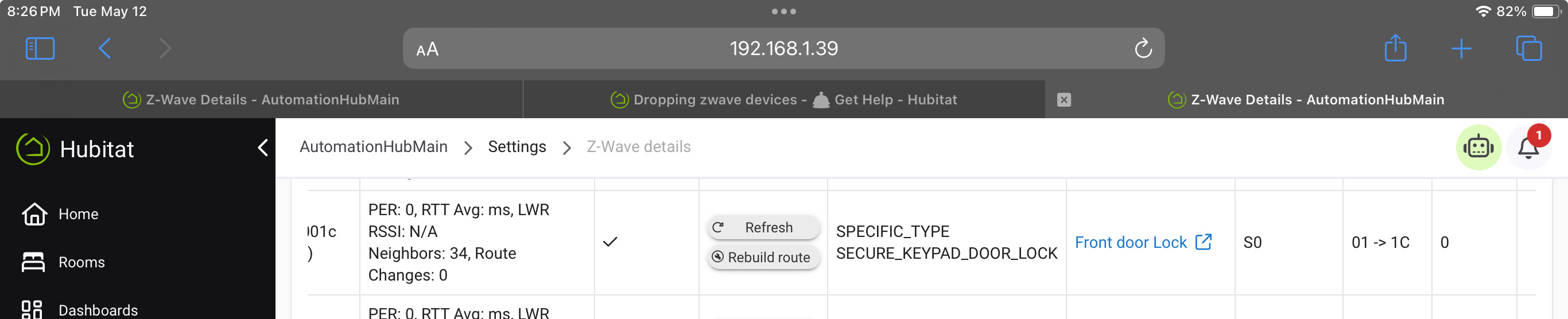

ugh. Rebuild failed unreachable.

Lock still doesn’t work at all. What does look more normal is that the comm path to the hub is direct (less than 10’ apart).

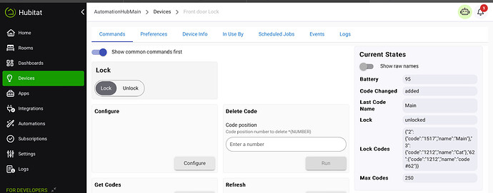

What does not is the fact that the button on the device tab (currently locked)
is counter to what one would expect from the device status (unlocked)
