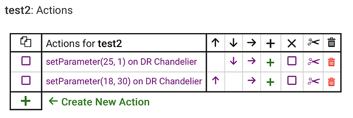

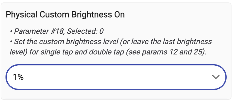

The other way around it would be to set the custom brightness on the fly. If you setup the parameters so that the light turns on to the custom brightness setting, you can then set that custom brightness from a rule using the Set Parameter command. That would basically pre-set the level for the next time it is turned on.

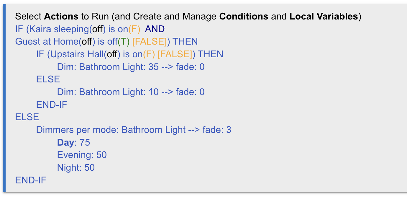

I never used RL after it was introduced. This workaround sounds great. For this RM rule, I would guess that I need two RLs - one with the restrictions, and one without restrictions (or probably NOT restrictions)?
You might not gain anything from that example moving it to RL. I also dont know what is triggering your rule?
What might work for your case is to have your normal conditions setup in RL, you could block the RL from running for any special cases. The special more complex cases you could then have a separate Rule in RM to handle. I do this in two bathrooms to have a slow ramp up for your eyes to adjust, but only in the morning during certain times. All the other normal cases are handled in one RL instance, but then these two special slow ramp is in RM so that I could restrict it further.

you totally don't like the SetParameter approach I outlined above?
I haven't tested the implementation yet. Light keeps turning on. Then I realized I was using the wrong command. :roll_eyes: Wanted to migrate over to Room Lighting.
Is there any drawback to having the setparameter approach every time the light turns on? I don't want to do something too much to screw it up. The alternative is to fire a rule on mode change and changing conditions, which would mean a handful of times a day.
You wouldn't have to set the parameter every time you turn the light on, would you. Single tap behavior parameter would be a once and done thing. You would just be changing the Physical Custom Brightness Level On parameter. It would stay that way, say, at 30%. If you wanted it brighter at the time, you could make it brighter, but the next time you turn it on it will go to 30%. Now you can change that parameter using the SetParameter command using a rule. As I said, maybe some condition like sunshine, time of day, whatever, could be a trigger to change the parameter. You could even use a variable parameter in your rule. You wouldn't be changing the parameter every time you flip the switch. It would be done in the background with rules.
Unless I'm misunderstanding what you want to do. It seems like this would fit the bill.
Good point I have not actually tested it. I was thinking that if you send an ON command instead of set level it would honor the custom brightness instead of using the "Last Level" but maybe not. Would probably need to use the Basic Set custom brightness but then also have the driver able to send a Basic Set command.
@velvetfoot is correct, you would not do this every time, you would just change the parameter for every mode you want a different default.
