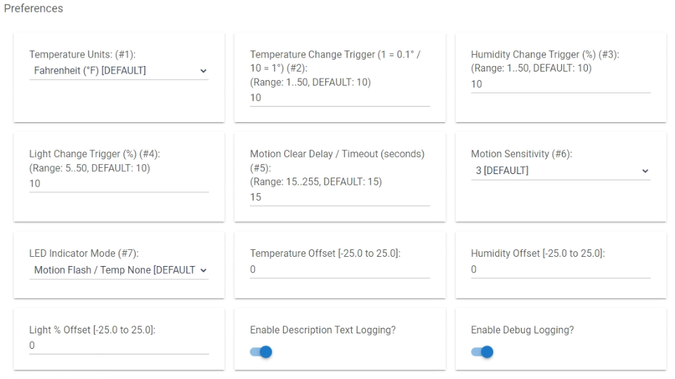

I've been playing with the triggers and offsets on my two 700's to tweak the frequency of reports and calibrate temp and humidity. [side note: they NEED calibration; will post results in a new topic] I have two questions:
  1. What's the right procedure for getting a parameter change synced?
  2. Should the sensors continuously report syncStatus : 1 Pending Changes?
I follow these steps when I change a parameter:
  1. Enter the new value
  2. Click Save Preferences
  3. Click Configure - sensor shows "syncing" for a few seconds
  4. Click Refresh
  5. Go to the sensor and push a pin in the hole to wake it up - LED flashes blue
  6. On my computer, I again see "syncing" for a few seconds

You can skip 3 and 4, you only need to save and then wake up the device.
I have noticed sometimes you have the refresh the page for the "Pending" to go away, I think this started with HE firmware 2.3.1. Otherwise, if the Pending Changes wont go away, something is not saving correctly. If you enable debug logging and then do a wake up, it should show in the logs which parameter it is trying to sync up. You can also check the "configVals" map in the bottom data section to compare the values with what you have set, they should match.
I think the "new" system driver was updated to work with the 700 series device. I am not sure if it is backwards compatible to the older devices. For my custom driver, I have nothing older than 32.02 to test on and I am not sure what parameter options may or may not work on older models. If you want to try it out and see if the Parameter 8 setting works on that older model you can let me know how it works. One other user was getting parse errors on an older device, which the logging should be fixed to get more info. I may need to bump the command versions down to work with the old models, which I have done in my test code but I have not posted it yet.
I see numbered parameters 1-7 and a few that have no number, but no #8. But I thought I read farther up you were hiding those from older firmware so I assumed that was why.
Log below for one of my sensors, but both are the same. The pending parameter not saving correctly is motionClear. I changed them yesterday at the same time.

[dev:164](http://192.168.1.5/logs#dev164)2022-04-22 12:46:58.823 pm [debug](http://192.168.1.5/device/edit/164)den sensor: Changing motionClear (#5) from 120 to 255
[dev:164](http://192.168.1.5/logs#dev164)2022-04-22 12:46:58.683 pm [debug](http://192.168.1.5/device/edit/164)den sensor: getConfigureCmds...
[dev:164](http://192.168.1.5/logs#dev164)2022-04-22 12:46:58.568 pm [debug](http://192.168.1.5/device/edit/164)den sensor: WakeUpNotification
Turn on debug logging, then press Refresh, and then wake it up. This will allow the driver to detect the settings and show the parameters. I should probably have it read the existing firmware if saved in the data at the bottom and use that since its a battery device and getting a refresh is a PITA.
Should be able to refresh the page after a minute and the parameters will show.
I suspect that the 255 is not the true upper range, it is 0xFF which is typically something reserved or not used. So I would try something a little lower like 250 or even 254 should work. I will test it on on mine later tonight and then fix the driver to be the true range so no one else runs into that.
A binary search yielded a quick result - max value is 127. Both set to that value and pending changes status is gone.
Thanks... I see parameters 1-7 and some without, but no #8.
I can't tell if those un-numbered ones are hold-overs from the old driver maybe?
The un-numbered ones are driver settings which do not tie to device parameters. I forgot I was able to confirm that #8 I think was added in 32.02 so anything lower than that it is hidden.
