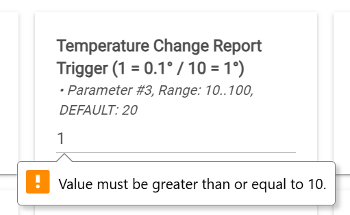

I've just installed the ZSE44 Temp/RH 800 series sensor. In the preferences section it says the Temperature Change Report Trigger Range is 10-100 but for the 800 series it is 1-100. If I try to use a value of 1 the driver complains, see screenshot below. I did try changing the range in the driver on line 180 but it did not help. Presume this needs an update somewhere else?
Screenshot 2024-12-19 172055
Yes it changed with the new firmware. Here is the GitHub issue with a simple patch you can make for now ZSE44 800LR Temp Reporting Threshold · Issue #34 · jtp10181/Hubitat · GitHub

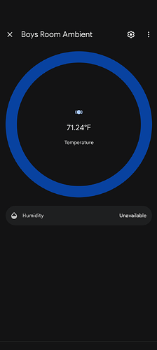

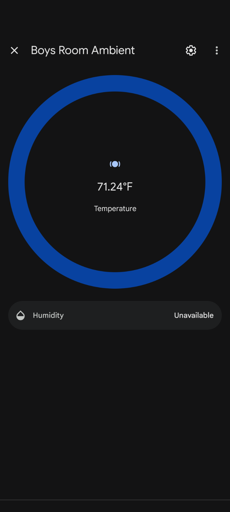

I added my ZSE44 to the built-in Google home integration but noticed it doesn't report humidity in the Google Home app. Is this an issue with the driver code or the platform code?
I would assume it is an issue with the GH integration. I am using the standard humidity capability and states. Could be tested with a virtual sensor that you share to GH, see how that works.

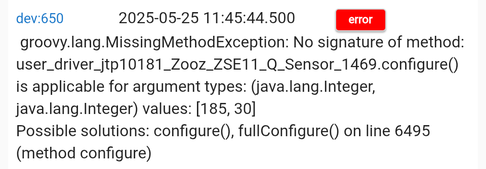

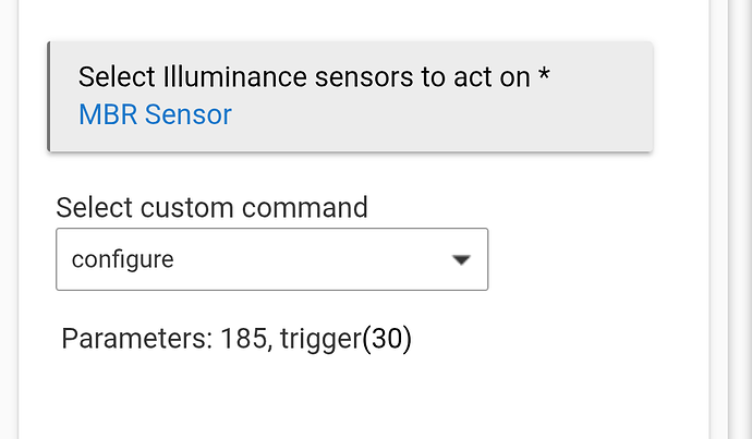

@jtp10181 I am trying to set parameter 185, the lux threshold, from RM. Using the Custom Command to configure Illumination on the device with parameters 185 and the threshold both as a number.
Have run configure on the device and pressed the zWave button for 3 seconds. No change.
Configure can’t take any parameters. Since you can’t change settings without walking the device manually I never put the set parameter commands on these divers. I suppose I could add it to the ones that have a usb power option if that’s what you are trying to do.
