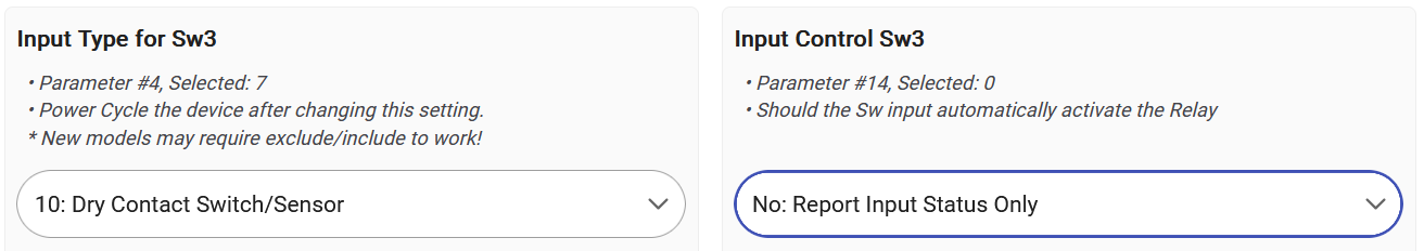

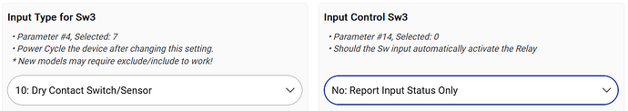

I am not entirely sure if it is an issue with the 3.20 ZEN16 firmware, this Advanced Driver or my own understanding of the description, but the behavior for the “Input Type for Relay X“ is not what is expected.
The combination of value “10 – on/off report (dry contact switch/sensor)“ and “Report Input Status Only“ for “Input Control SwX“ does give the proper Sw status but still triggers the relay while the description implies it would not trigger.
My workaround was to use “7: Contact Sensor“ instead which does not matter for this application but wanted to let you know about this unexpected behavior.
Did you exclude then include again after adjusting those settings?
Also I have had mixed results with the "Dry Contact" options on various Zooz devices. They seems to insist on sending switch reports on different endpoints instead of just sending some sot of sensor notification on the same endpoint as the relay like every other option does. So it makes the driver on Hubitat a bit more challenging.
