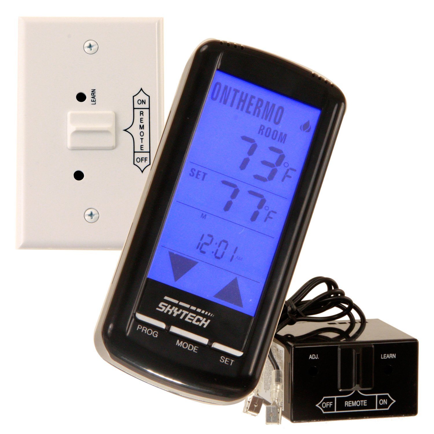

I just hooked up a ZEN17 to my fireplace, installed the driver and included this device in Hubitat and Google Home. Everything works fine. I can turn it on via Hubitat or simply with "Hey Google, turn on/off fireplace". I also connected my old thermostat control (image below) to the S1 and C terminals on this relay and (my wife) can now control the fireplace the old fashion way or as I stated above.
Now here is my problem. Using the Skytech remote as a thermostat set to a specific temperature along with this drivers option Auto Turn-Off R1: TIME could result in the relay shutting off (time ran out) the fireplace while the thermostat still has not reached its set temperature. The thermostat assumes the FP is still on and if I lower the temperature below its current setting it sends a signal to turn it off but in fact, because the FP is already off, it turns it back on. For now I have set the Auto Turn-Off R1: TIME to zero

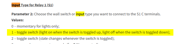

Change the input type. Sounds like you have it set to option 2, you need 1.
I have it hooked up exactly as shown in this video. The only difference is that I have a battery RF remote with a receiver connected to S1 and C terminals while the guy in the video uses a wall switch connected the same terminals.

You are right. I have option 2 and will try your suggestion. Will get back to you after I do some testing
SOLVED
:grinning: That did the trick. Thanks for your help
