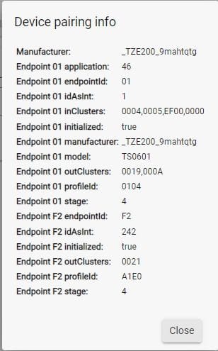

I was needing some help to get the driver for this switch. did anyone manage to make it work?
Fingerprint
Zemismart
Zemismart 6 gangues tuya zigbee

Can you try this driver?
https://raw.githubusercontent.com/martinkura-svk/Hubitat/main/Moes%20ZigBee%20Wall%20Switch
Click on the 'Initialize' button and then press F5 in the browser to refresh the device web page.
If it doesn't work, then turn on the "Enable debug logging" option and copy/paste the text from the device log page when you manually press the device physical buttons 1..6
Hello @kkossev,
It worked! I can individually activate the 06 keys of the switch.
The function of turning off all switches did not work. It only turns on/off the first 3 keys.
thank you for your help.
