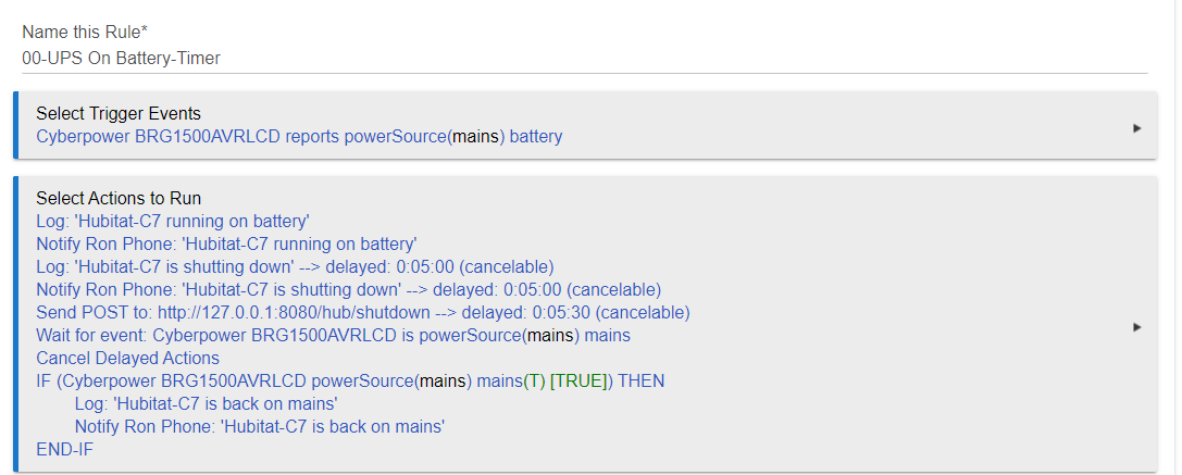

I had a good test of this last night as we lost power, I don't have the timer in the actions yet just used battery percentage, power came back up after about 4 minutes but everything looks like it's going to run well. Below is my rule machine code as it sits now, if I get some free time I will incorporate runtime vs. percentage of battery.
I finished up my rule for using time on battery vs. percentage battery remaining this is what I came up with. Just figured I would share it with the community.
Just a minor edit, forgot to make the delayed events cancelable.

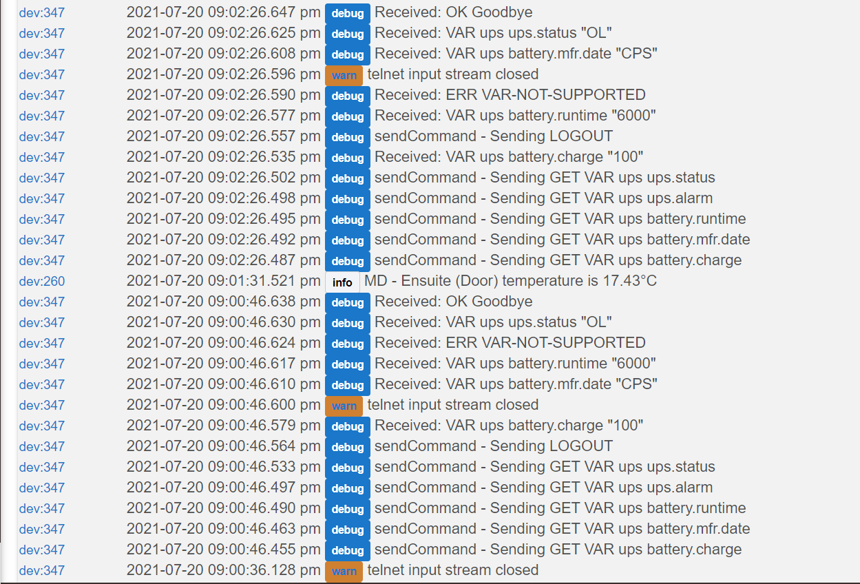

Anyone else see this being broken with 2.2.8? I'm not sure if it was 2.2.8 or if it was upgrading my Synology to DSM 7.
Looks like if I enable Debug on the parent NUT driver, things work. If I disable Debug, logs just show:
dev:21092021-07-19 13:09:29.331 errorParseOK: Couldn't process message: "[]"
dev:21092021-07-19 13:09:28.304 infoOpening telnet connection
Though looks like it's still closing connection.
dev:21092021-07-19 13:10:43.819 errorParseOK: Couldn't process message: "[]"
dev:21092021-07-19 13:10:43.813 debugIntegration - NUT: Received: OK
dev:21092021-07-19 13:10:43.790 debugIntegration - NUT: Sending USERNAME monuser
dev:21092021-07-19 13:10:42.772 infoOpening telnet connection
dev:21092021-07-19 13:10:36.529 warntelnet input stream closed
dev:21092021-07-19 13:10:36.478 errortelnetStatus: receive error: Stream is closed
Everything working fine for me!
Yeah, it seems to be working. Odd though.
Will keep an eye on it.
I checked it was working on my C4, before upgrading to 2.2.8. It was.
I upgraded, and now it's showing errors.
(edit: synology NAS on 7.0 also)

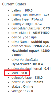

Question: I'm trying to monitor watts using this. I see volts, battery volts, and a suspicious "load" but the associated # isn't making sense, Anyone have any insights into figuring out what I'm looking for? The load (in watts) should be more in the 300-400 range... So it ain't watts,... or amps

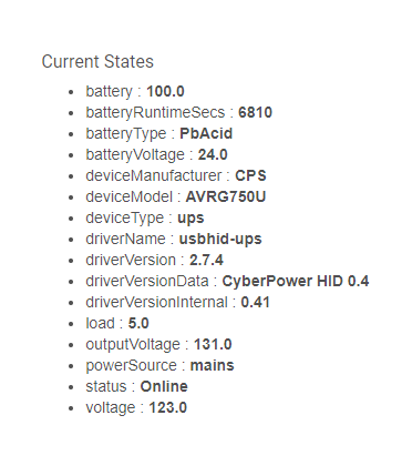

Load is supposed to be the load on the UPS in percentage of it's capacity, for mine here:
at at my mom's house:
