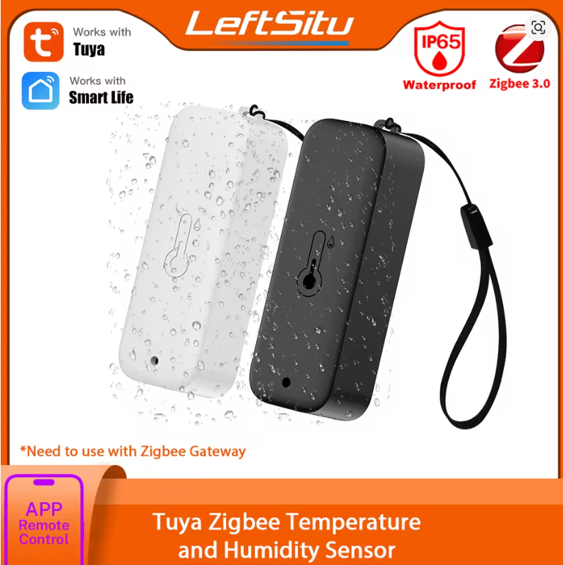

Driver for Outdoor Temperature / Humidity sensor ZTH11 (TS0601)
Dear Community,
I bought this sensor to replace my Aqara sensors outdoors, but found no suitable driver.
Anyone managed to make them work?
Thank you in advance.
Regards,
Gergő

https://www.aliexpress.com/item/1005010019695092.html?spm=a2g0o.productlist.similar_items.4.be7bFdduFddu1x&utparam-url=scene%3Aimage_search|query_from%3Aback_detail_bigimg|x_object_id%3A1005010019695092|_p_origin_prod%3A&algo_pvid=b5ed75a8-4f36-48a9-b958-4b3efee607ca&algo_exp_id=b5ed75a8-4f36-48a9-b958-4b3efee607ca&pdp_ext_f={"order"%3A"18"%2C"fromPage"%3A"search"}&pdp_npi=6%40dis!HUF!4359.70!2746.65!!!89.84!56.60!%40211b613917622003652803338ec43a!12000050856338217!sea!HU!0!ABX!1!0!n_tag%3A-29910%3Bd%3Aab8c1c40%3Bm03_new_user%3A-29895
Try searching the forum for drivers from @jtp10181.
You can also install his bundle from HPM and have a look and see if it's in there.
Chances are the regular ZSE11 will work fine.
OP is talking about a Tuya zigbee device.
Jeff doesn't do zigbee drivers. There no compatibility whatsoever between OP's device and a z-wave ZSE11.
Ha, sorry - true.
I have ZSE11's so my tiny brain didn't read the longish story and just associated the part number with the Zooz line.
Perhaps @kkossev will help? :slight_smile:
That would be nice...
try this one. It will most likely work.
Thanks. I tried this one and didn't work. I use it for an earlier version (non waterproof), however I added the driver 1.5 years ago. That one didn't work.
I give a try to the most recent one
The new version works just fine.
Thanks for the help.
