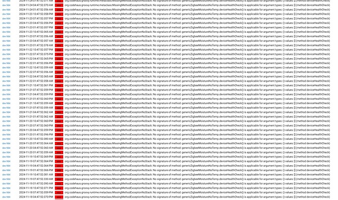

I am getting hundreds of error messages per second in the log:
"org.codehaus.groovy.runtime.metaclass.MissingMethodExceptionNoStack: No signature of method: genericZigbeeMoistureNoTemp.deviceHealthCheck() is applicable for argument types: () values: (method deviceHealthCheck)"

You should see this error only once per hour... Can you post a screenshot of the error logs?
I switched to your "Tuya NEO Coolcam Zigbee Water Leak Sensor" driver and it seems to work well, no more error messages. Here's part of the log with the internal driver:
(edit: oops - looks like I did not pay attention to the hours in the log and only saw the same minute and ms changing - the entries came every 3 hrs... but anyhow, with the new driver, it seems to be clean now)

I have to think about how this could happen... Seems like the scheduled job is trying to execute every millisecond.
If you decide to go with the inbuilt driver, perform the 'Delete All Scheduled Jobs' procedure first. Or just stay with the NEO driver for now.
The NEO driver is just fine - but look at the logs - it is every 3 hrs - just the minute stays the same and ms are changing :slight_smile: So, not as bad as I thought!
