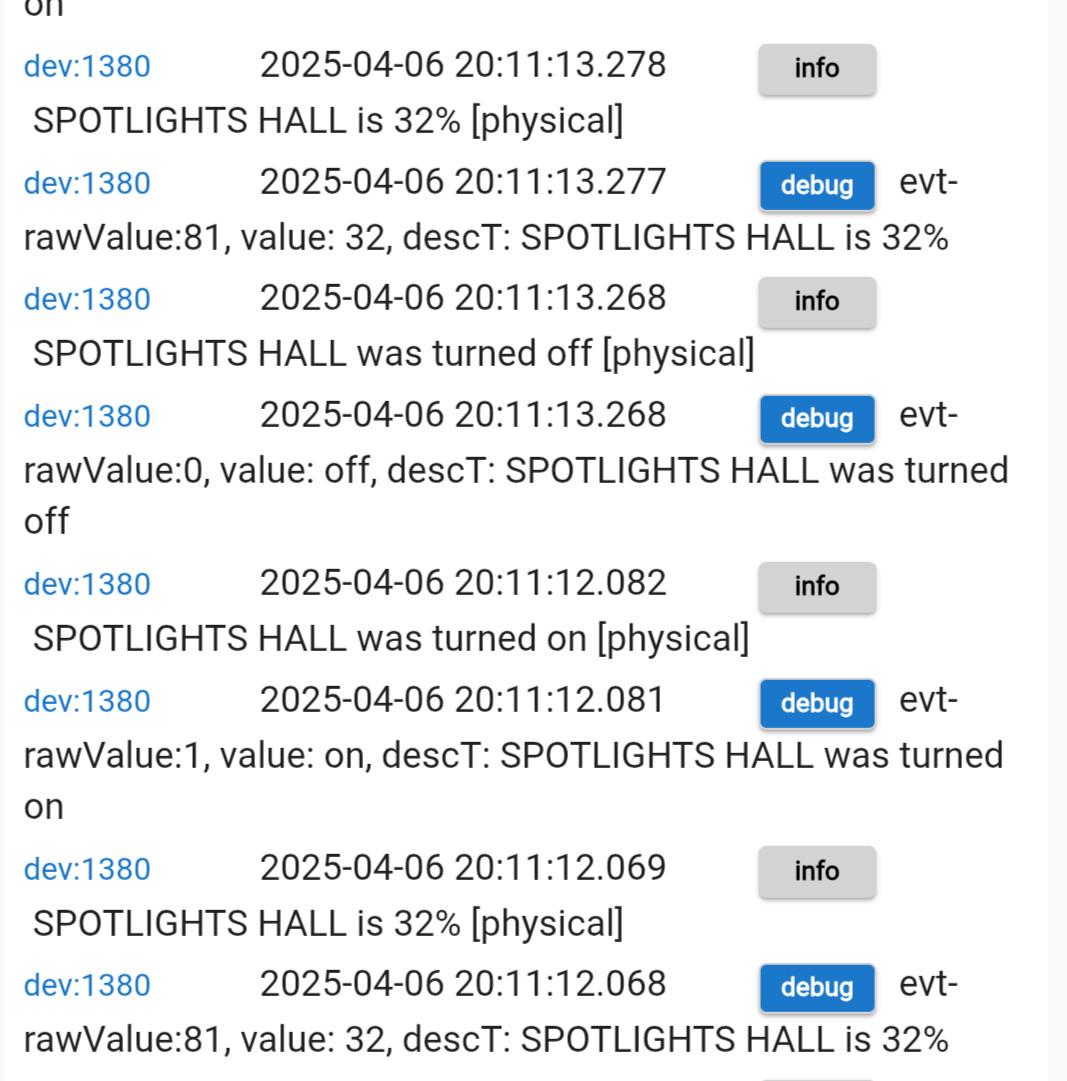

Ok folks, so after much testing on and off. The SM323 MK2 seems to randomly turn itself off when physically turned on when the dial is rotated. This occurs immediately and within a second of turning the dimmer dial on. This is an inconsistent issue but definitely occurs. Does anyone have a solution to this. I thought this product was excellent but this bug frustrates me. See logs :slight_smile:
