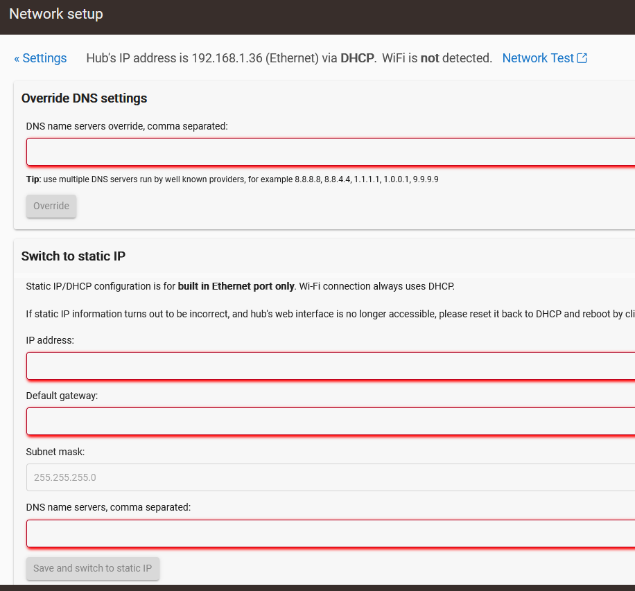

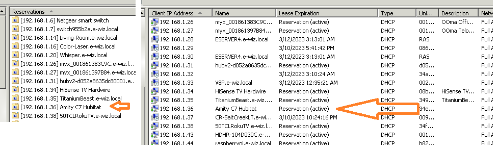

Do you have your hub reserved in your router?
My Domain Controller takes care of it - dhcp and dns records both.

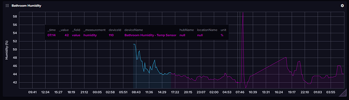

The only thing I personally changed is recently (in the last 3 days) I began implementing InfluxDB2 logger app to write out to an influxdb on my NAS which seems to be working rather well.
2nd crash last night - about 8h 47 mins ago. hub light green, just - dead. nothing in logs.
I haven't touched the IP settings since last year - no need afaik (and no desire - dhcp handles it all).
