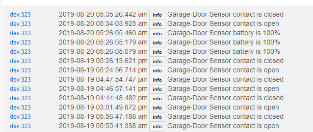

Here is the sensor log:

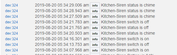

I think what is happening based on the door sensor log is that the power reporting also fire the "changed" event. The siren went off 4 times, there is one open even, and 3 power reporting events. Is the "changed" condition is the driver also capturing the battery level even and classifying it as changed?
