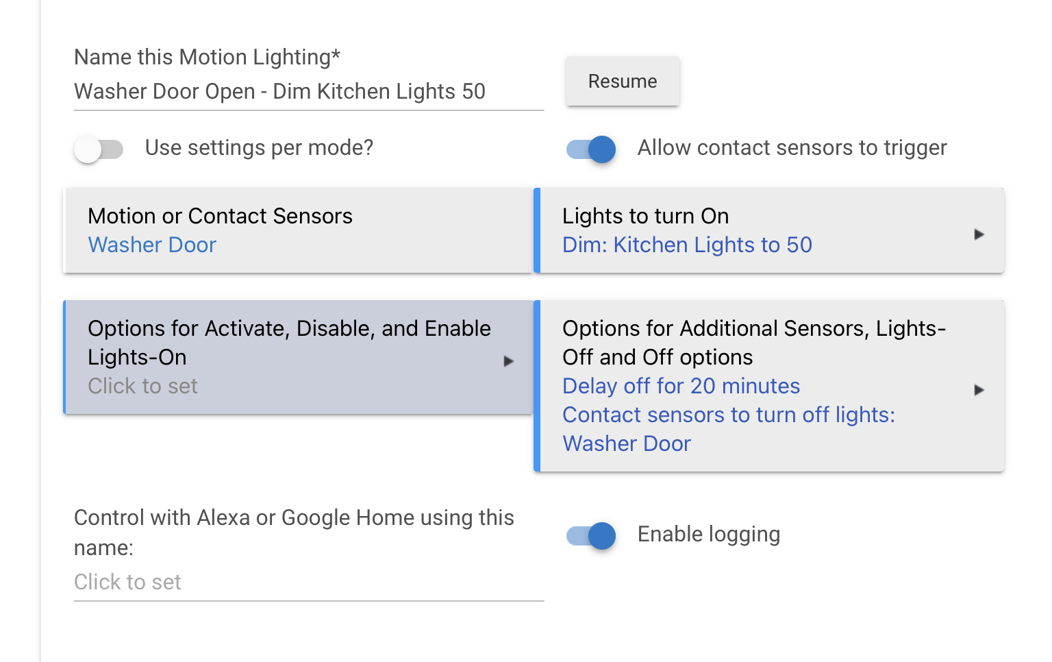

A couple of things there. You can probably do what you want without using multiple apps.
Using Motion Lighting, you can set up "contact sensors to turn on lights when open" - you don't need t assign a motion detector. Also you can set the dimmer level, so that it sets that level every time rather than turning on at a default value.
Example (I just tested and this works):

Try it like this instead. It might need the contact sensor to be the initial trigger in order to respect the delay off. Here I've enabled the "allow contact sensors to trigger" and selected it in the first box and also deleted the contact sensor bringing the lights on in the lower left box.
