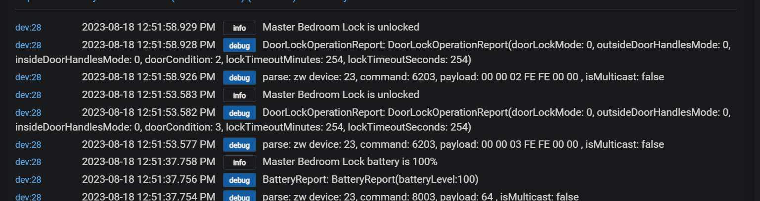

New firmware available. I just pushed it with my C8, and it does actually show in the logs.
Would I need to create a new device driver to track this new attribute, or is there something existing that might work?

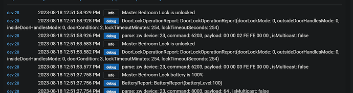

The doorCondition: 2 vs doorCondition: 3 appears to be what we need.

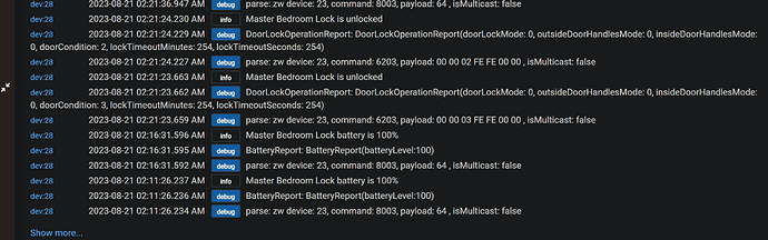

Here are the latest unlock entries for mine. I'd have to compare them and test a few different users to see if anything useful is there. The door position is a nice addition regardless.

I can confirm that when I just open/close the door on an updated lock, I get Zwave responses:
on one of my other 3 locks, I get nothing. Only when actually locking/unlocking.
