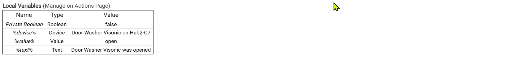

Or use a private boolean to prevent simultaneous instances.
Here's what I use for repeating laundry announcement w/private boolean & stop repeating actions:
I see you have the stop repeating actions in the repeat. That’s the thing I learned. Without that you get random, lingering notifications. Thanks
