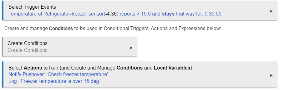

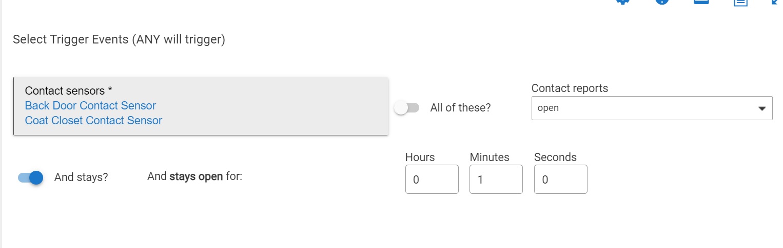

Another option would be to use what is referred to as a "sticky trigger"...

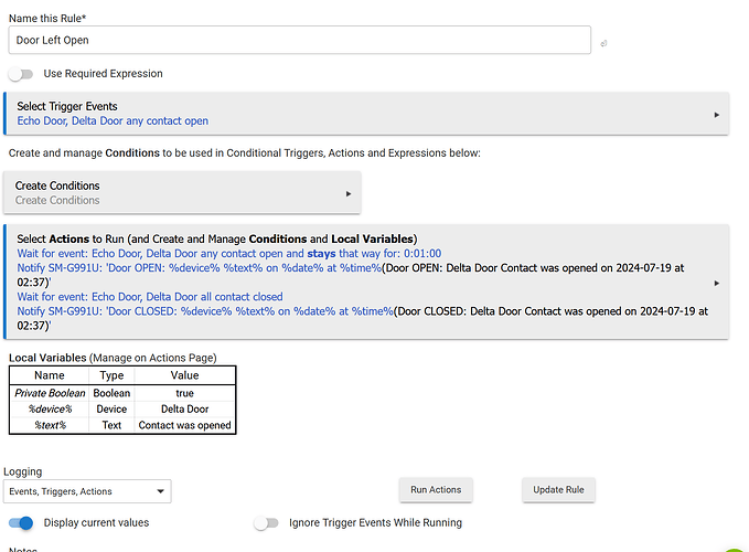

Echo door, delta door any contact open and stays that way for 1 minute.
One example....
You can also refer to this post.....How to use sticky triggers - #2 by bobbyD

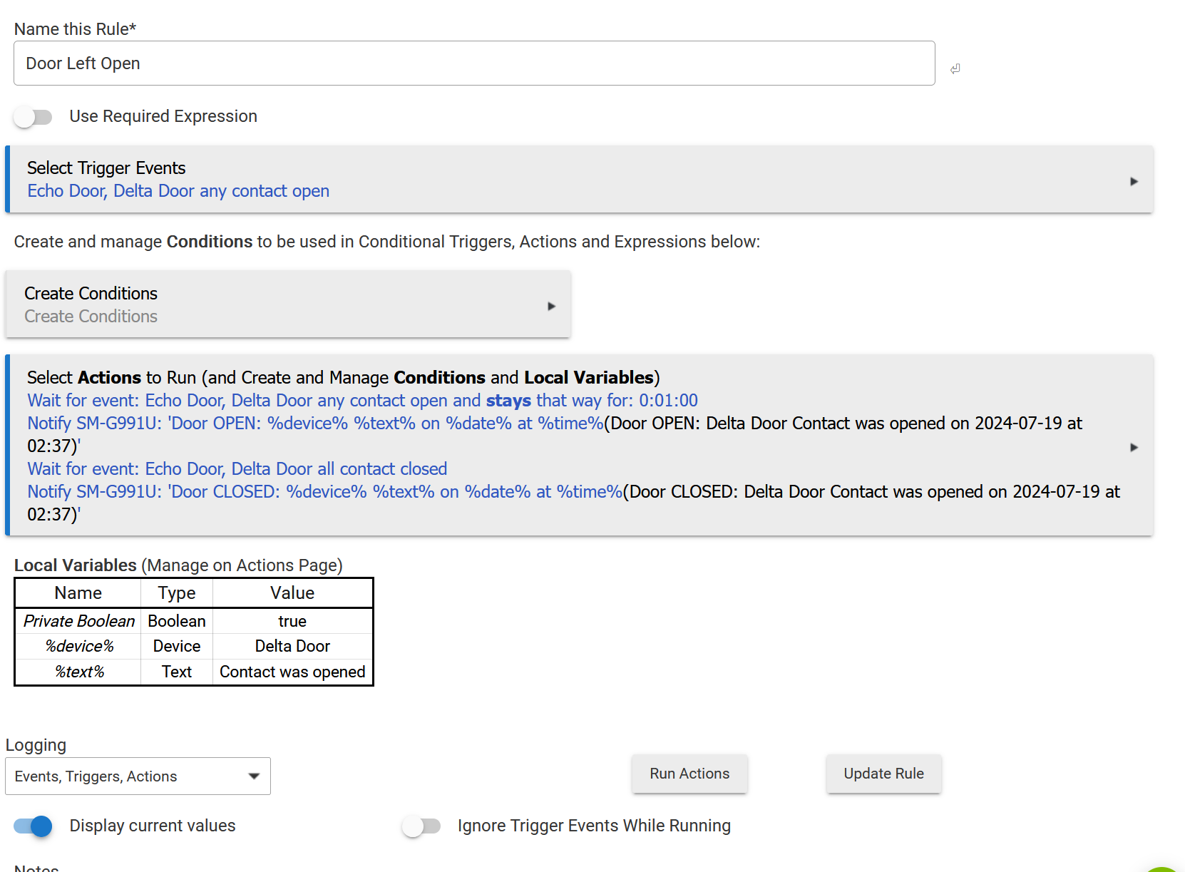

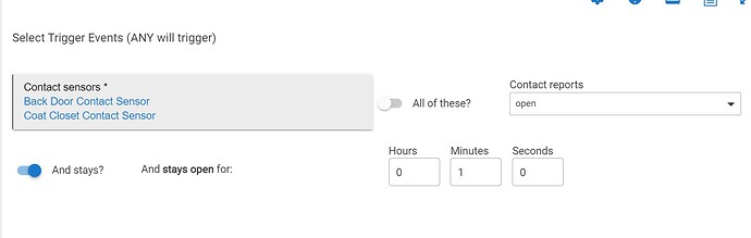

@Sakman's suggestion is the correct way to go. You can combine them similar to below.
Just select the "And stays for one minute" right below the sensors. This would allow you to remove the first wait for event.
Hey, thanks, @Sakman! Your solution was easy and worked!

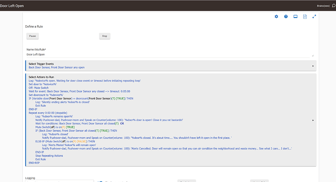

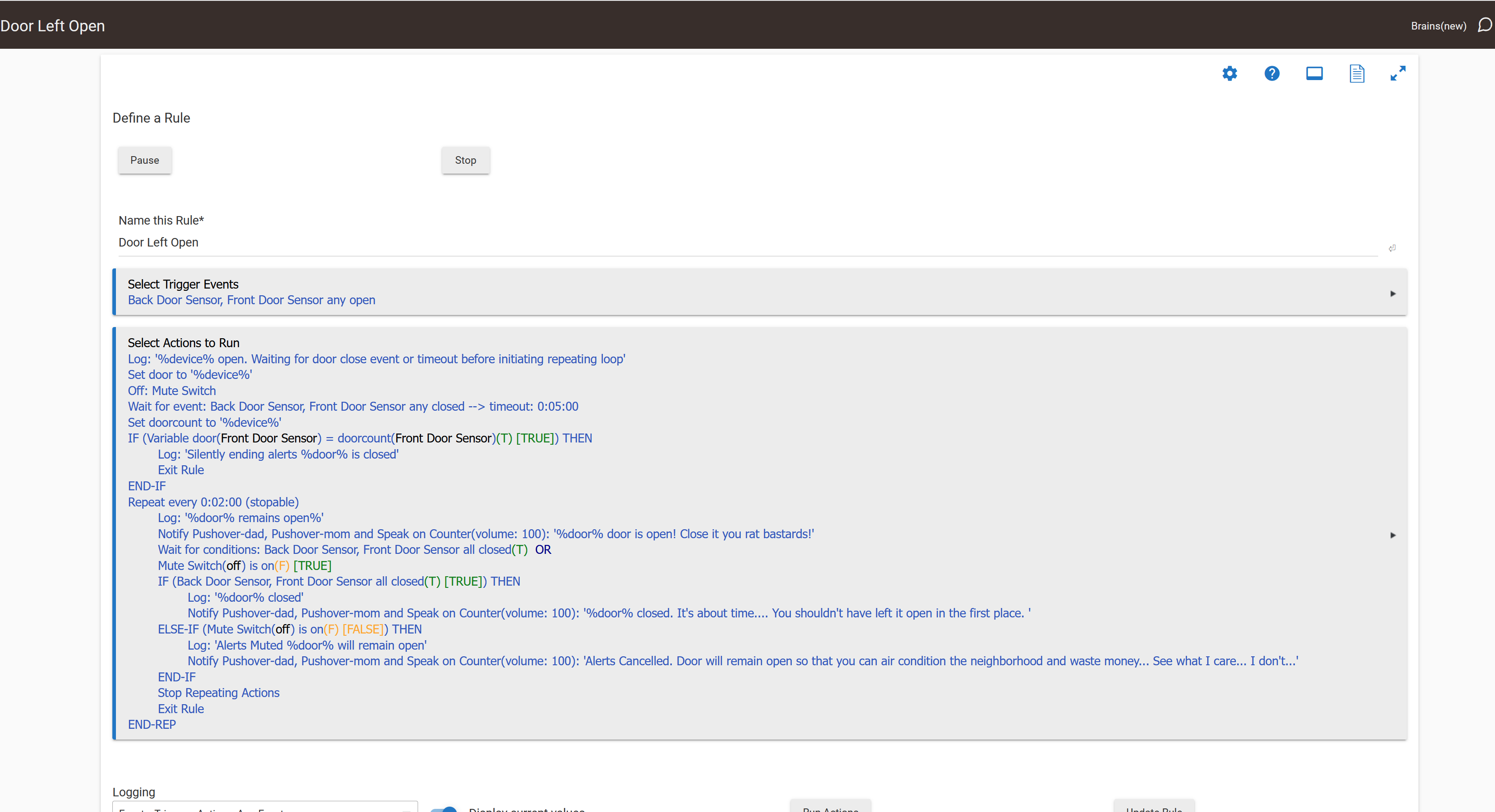

This is how I do mine
Note Mute Switch is a virtual switch
When the door closes it notifies.
