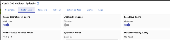

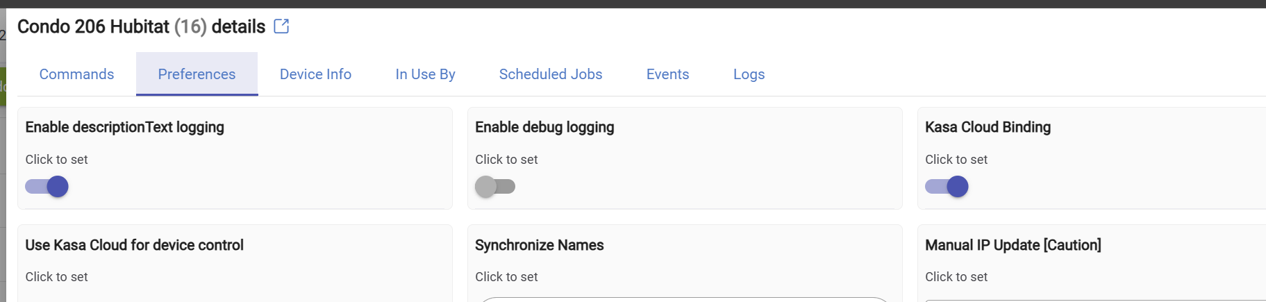

just make sure even if local not to uncheck the bind to cloud toggle in the app.. its counter intuitive as makes you think with it on it will use the cloud integration and not local.. but if you uncheck it .. it stays local but unbinds it to the cloud and then disappears in the kasa phone app.
I have ten assorted Kasa plugs. It never occurred to me to uncheck that setting. For a long time I was skeptical of any WiFi devices but those with a local integration -Kasa and Wiz for me, have been flawless.- Seasonal stuff because of the mesh. A few others because they just work and are inexpensive. Four of them to toggle power to Linptech/Moes occupancy sensors twice a week in the middle of the night. Wiz floods at half the cost of Hue.
