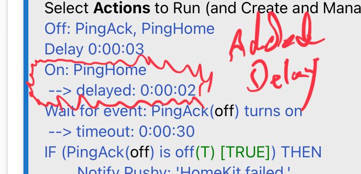

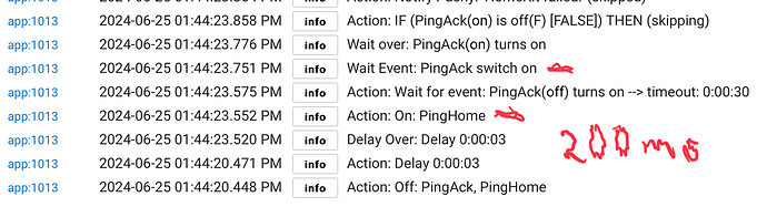

Good point… I never would have thought that HomeKit automation could be that fast.
In any case it would successfully complete in 30 seconds, right?
Or the hub could be under more load than usual and take more time to get to the next action (Wait) than it took for the Homekit integration to register the change in PingAck.
The wait would time out, but you are correct, since you are checking against the state of the switch right after, the result would be the same, delayed by up to 30 seconds.
Per @hubitrep excellent suggestion, I delayed the ON by 2 seconds.
