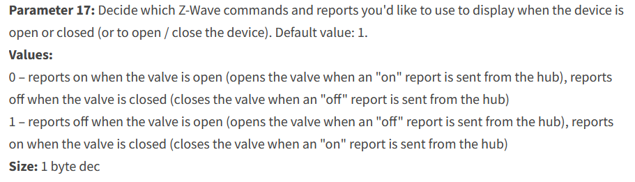

Not that it's a Dome, but if you had a Titan by Zooz, I think parameter 17 would do it.
You know, I actually looked a fair bit just now and found nothing on the Dome shutoff valve and parameters or advanced settings. I think that's a first for me-that no parameters are published for a device. I'm a relative newbie though.
