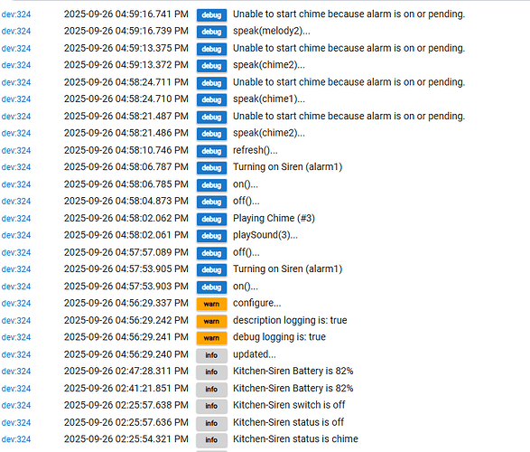

I thought everything was working to weel after moving to my C-8 Pro. Today my Dome Siren is no longer reponding to chime commands or anything else. Sometime after 2:47 PM CDT. This is what I am seeing in the logs:
I tried an update from the device page and nothing, you can see the test chime and nothing plays. Don't know what is pending other than messages aren't getting to it since its a battery device. Here is the Zwave device info for it:
