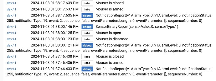

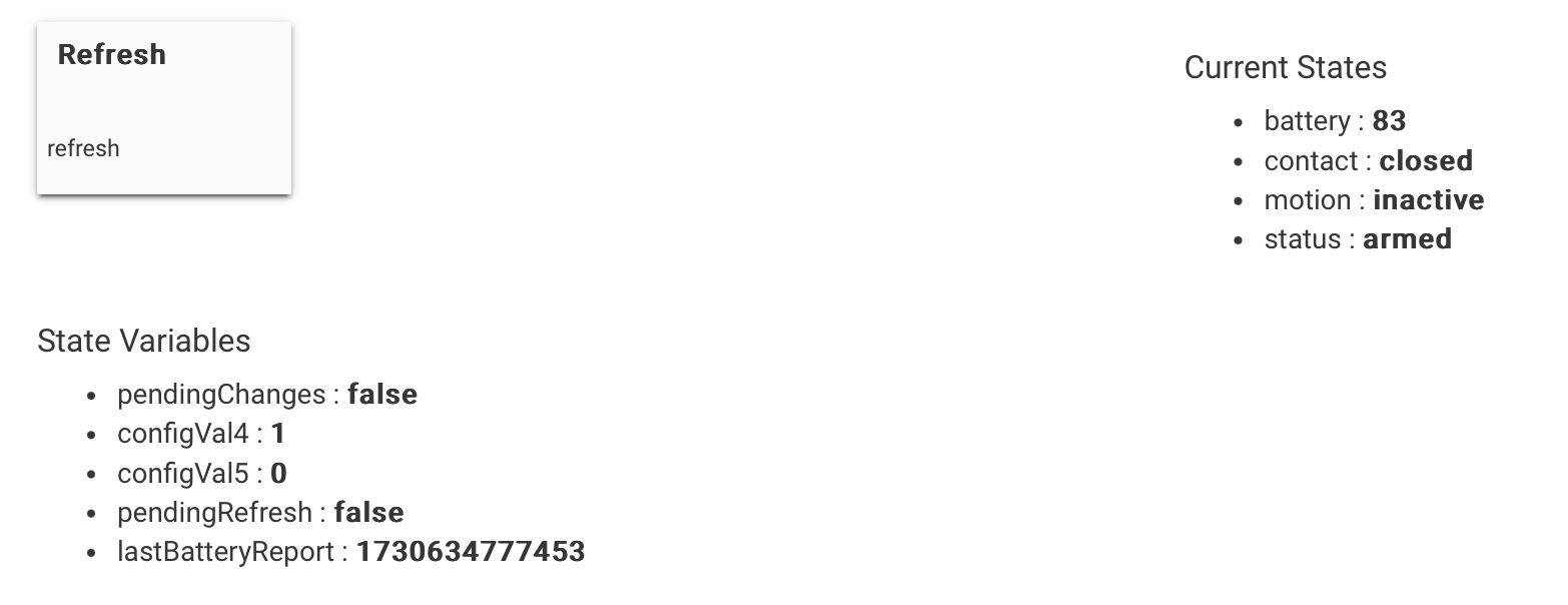

Researching the few posts here about the Mouser, I read that tossing a damp paper towel in the trap should trigger the trap. I can hear the zapping, and the red LED turns on, but there is nothing in the log about motion sensed.
The log only shows when I turned the switch on and off. The log doesn’t change when I toss a damp paper towel inside even though the red LED is on and the Mouser is buzzing away.
The states change when I turn it on and off which tells me it is linked to HE. For grins, I included it again, with no difference. Then I excluded it and included once more. No change.

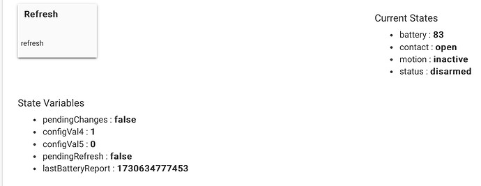

The states change from closed and armed to open and disarmed when I turn the switch on and off.
Motion never changes to active.
Using the ā€˜Dome Mouser’ driver.

When mine activate, there are actually two device events: motion changes to Active, but also status changes from Armed to Tripped. Are you seeing either of these fire?
No status change and no events. I’m thinking the Zigbee part is kaput. Not getting rid of it since it still zaps. Just need to check the LED from tine to time. Put a few Cheetos Puffs in the holder. My wife insists she heard scratching in the basement.

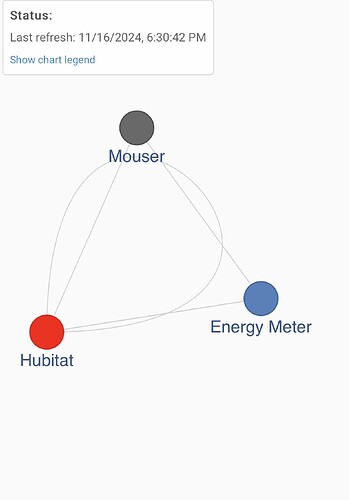

You just gave me an idea. I only have two Z-Wave devices.
The energy meter appears to be a repeater. I know in Zigbee repeaters are a must.
Could the addition of a Z-Wave repeater correct this? If so what is recommended (other than Zooz)
How far is the mouser from your hub? And are there walls or other obstructions in between? That’s a decent proxy for your question about the importance of repeaters.
A simple way to test the theory would be to exclude the mouser then include it right next to the hub. Then do your paper towel test. If it works, you can reasonably conclude distance was the problem (and repeaters a good solution).
I sat the Mouser about 6ā€ from the C7 hub, did an inclusion by pressing the button under the top housing containing the batteries which found the Mouser already installed. I then did an exclusion and another inclusion, tossed the damp towel in the trap, heard the buzzing, but the log did not show motion changing to active. The red LED on the Mouser lit when I towed the damp towel in. The state did not change to active.
