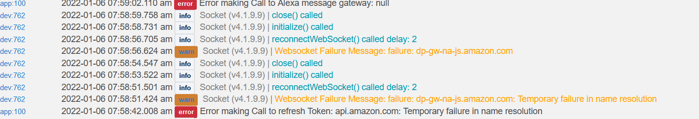

My main issue at the moment is the unofficial Ring Integration app. Error Logs:
[dev:762](http://
device ip/logs#pastdev762)2022-01-06 06:19:59.401 am [info](http://device ip/device/edit/762) Socket (v4.1.9.9) | close() called
[dev:762](http://device ip/logs#pastdev762)2022-01-06 06:19:58.385 am [info](http://device ip/device/edit/762) Socket (v4.1.9.9) | initialize() called
[dev:762](http://device ip/logs#pastdev762)2022-01-06 06:19:56.369 am [info](http://device ip/device/edit/762) Socket (v4.1.9.9) | reconnectWebSocket() called delay: 2
[dev:762](http://device ip/logs#pastdev762)2022-01-06 06:19:56.318 am [warn](http://device ip/device/edit/762) Socket (v4.1.9.9) | Websocket Failure Message: failure: dp-gw-na-js.amazon.com
[dev:762](http://device ip/logs#pastdev762)2022-01-06 06:19:54.265 am [info](http://device ip/device/edit/762) Socket (v4.1.9.9) | close() called
[dev:762](http://device ip/logs#pastdev762)2022-01-06 06:19:53.249 am [info](http://device ip/device/edit/762) Socket (v4.1.9.9) | initialize() called
[dev:762](http://device ip/logs#pastdev762)2022-01-06 06:19:51.233 am [info](http://device ip/device/edit/762) Socket (v4.1.9.9) | reconnectWebSocket() called delay: 2
[dev:762](http://device ip/logs#pastdev762)2022-01-06 06:19:51.181 am [warn](http://device ip/device/edit/762) Socket (v4.1.9.9) | Websocket Failure Message: failure: dp-gw-na-js.amazon.com: Temporary failure in name resolution
Can you repost your log as a screenshot?
It’s hard to read when posted as plain text.

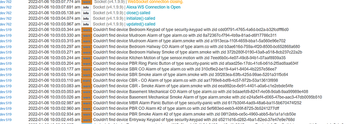

Seeing my ring devices no longer connecting.
