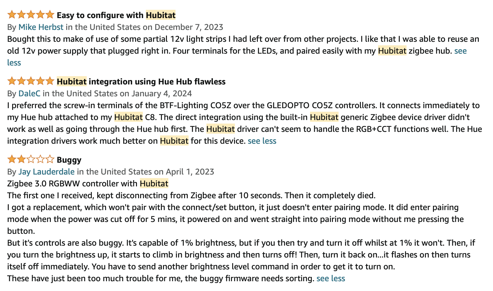

If the seller adrvertizes the dimmer as being Philips Hue compatible, the chances that it will work with Hubitat are very good. Most probably, the right driver will not be selected automatically upon the initial pairing - you will need to change the driver manually, assigning one of the HE inbuilt Zigbee Dimmer drivers.
Searching the reviews for the product with the keyword "Hubitat" brings up the following ....
