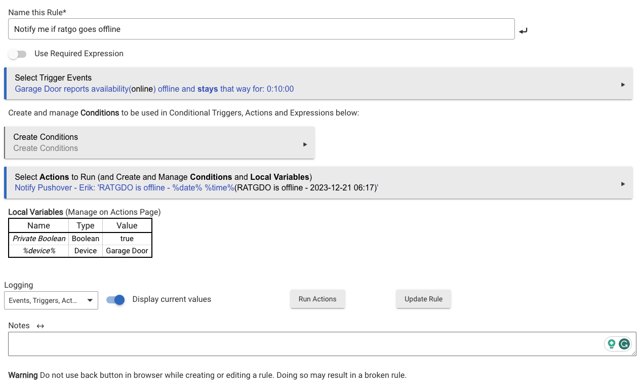

I have a device which "availability" status can go from "online" to "offline" and I created a rule to alert me if it stays offline for more than 10 minutes. However, it seems that the following happened:

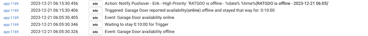

  • 6:05:30.326 : device availability goes to offline
  • 6:05:30:405: device availability goes back to online - 79ms later
  • 6:15 the notification goes out reporting Triggered: Garage Door reported availability(online) offline and stayed that way for: 0:10:00
So it seems that the rules engine is triggering on stay that way even though within milliseconds, it reverted to online.
Am I doing something wrong?

Rule looks ok. Looks like a bug to me. I have rules using the Stays that way and they work fine, so I assume it's something with the driver for your device.

Those times in the device availability events and the logs look a little odd...
I suspect this is the crux of your issue. While it's possible something could be done at the app (rule) level to address this issue, this seems like a better problem to address at the driver level. Surely it was not truly offline for only milliseconds?
In general, it's best to avoid events for the same attribute coming in within mere milliseconds of each other. Apps with a subscription to that event will wake, for both if that is what they are subscribed to, and it's possible the first instance won't have finished running before the second starts. What state you end up in, then, may not always be predictable (depending on how the app stores anything it might need to related to this data -- things like state or atomicState, for example -- and which one actually finishes first). Anything you can do in the driver to avoid this is likely to make most apps work better.

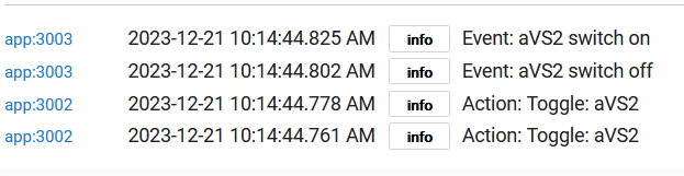

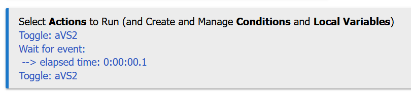

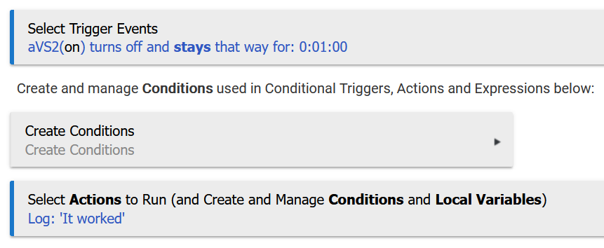

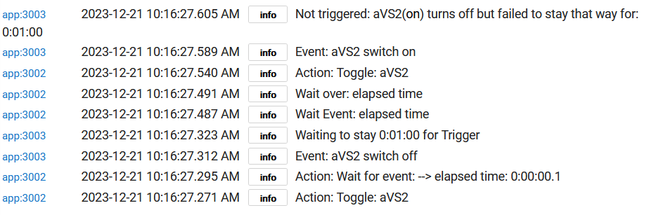

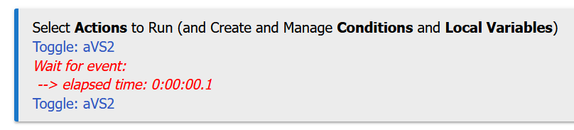

I created two simple rules to try to test this out and I think it's a timing issue meaning the events are happening too fast.
If I toggle aVS2 as fast as possible the first rule doesn't trigger
If I add a 100 ms delay (logs show < 300ms) then it works
Looking at the device events they are actually more than 2 seconds apart, it's the time between them registering with the rule that is short for some reason. The offline log from the rule is a "long* time after the device event compared to the same difference for the online event / log.
All good advice & suggestions. Following @pseudonym post, I'll add a delay within the actions of the rules to see if I can give it a bit more time to bounce back. Not sure how I would fix this in the driver and whether I'd want to. The device went offline for 2 seconds, that's the reality of things. While I don't think it went "Wifi" offline, its connection to the MQTT server did from the point of view of the latter.
I'm not suggesting a delay as I don't think you can force a delay between events. I'm just showing that a longer time between events worked where quicker didn't.
