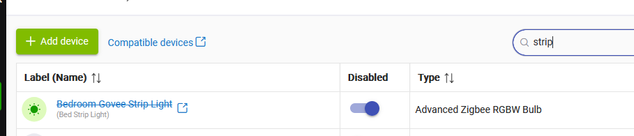

I recently (more than a week ago) lost a strip light controller. While waiting for the replacement to arrive - I 'disabled' the failing unit in HE Devices.
This seems to have broken / affected things in a bad way. Specifically - I have a rule for mode changed to sleeping - and the rule has been hanging up without running correctly.
