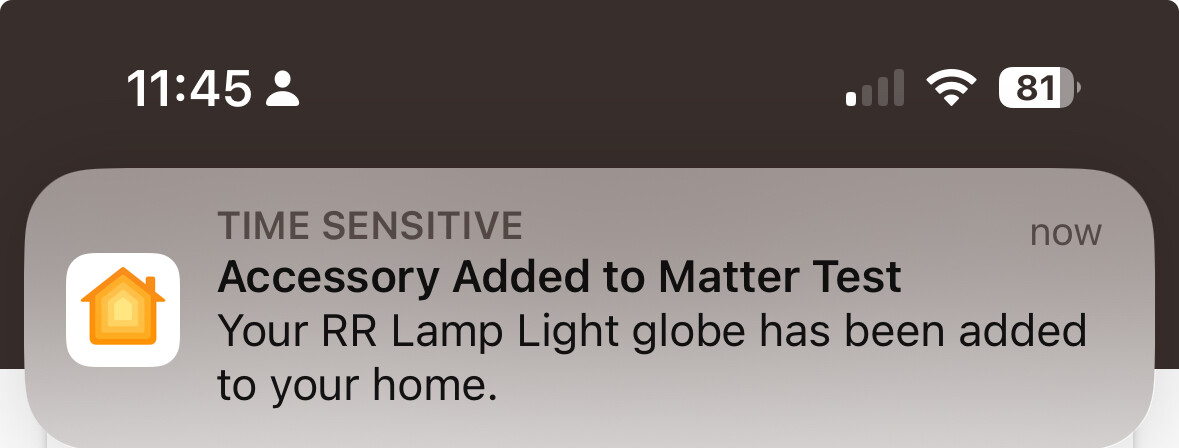

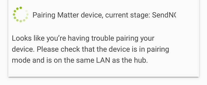

Hmm, I expressly allowed my HomePods to talk to my IoT VLAN, but I get the same result, homekit says pairing worked:

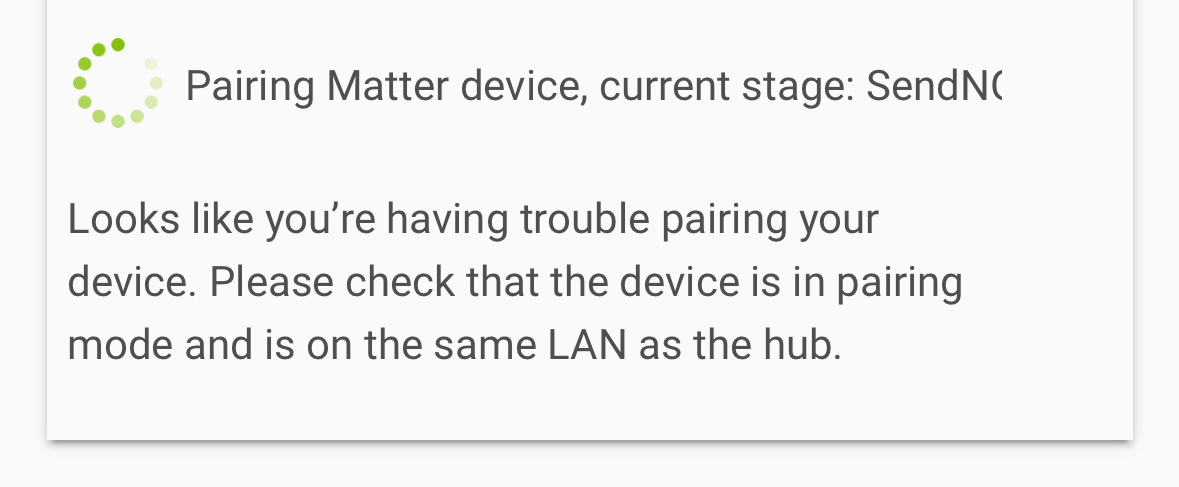

But Hubitat fails to finish the process:

I also tried removing it from HomeKit, pairing it to the Tapo app, updating the firmware, removing it from the tapo app, pairing it to HomeKit, and then tied pairing it to Hubitat. And I got the same result - I just cant get past the "SendNOC" stage. :frowning:

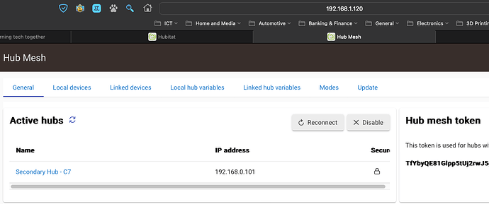

Have you tried adding the subnet to the hub, I.e.:
http://<yourHubIP>/hub/allowSubnets?123.123.123.0,124.124.124.0
Honestly, I didn’t know that was possible, I’m going to try it now. :+1:t2:

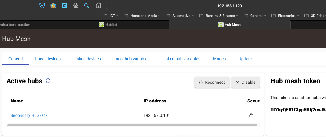

Hmmm, I’m not sure if I’m doing it right - my hub is in 0.0 and my main subnet is 1.0
http://192.168.0.100/hub/allowSubnets?192.168.1.0,192.168.0.0
That should give the hub visibility, make sure to do it on all hubs in the mesh.
Cheers, I’ll try moving one of my hubs tomorrow.
You, sir, are an absolute legend! :ok_hand:
It freaking works!!! :scream:

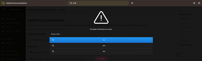

@bobbyD Why is this sort of thing not documented? When I searched for VLAN in the Doco yesterday, I got zero results.
Argh, even after moving my primary Hub back into my main VLAN, I still cant get past the "SendNOC" part of the process. Anyone got any ideas?
NVM, one more hard reset and I was able to get it to pair to HomeKit, and then Hubitat! Huzzah! :tada:
