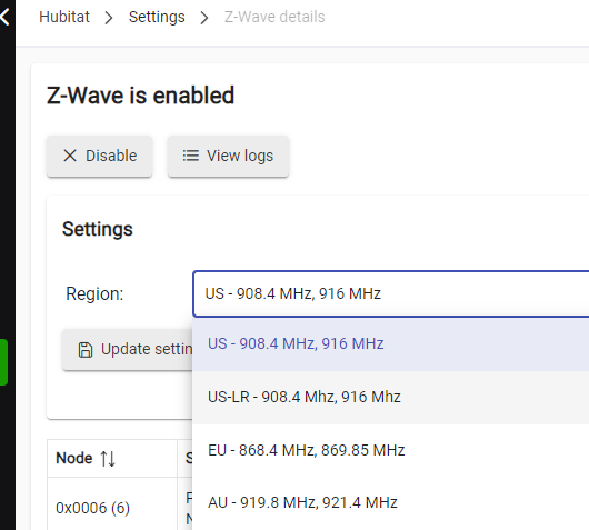

I've seen so much conflicting information out there so I am hoping someone can give a clear definitive answer. Specifically, I am trying to use LR to pair some Zooz ZSE42 leak sensors that have the 800LR chip. I have a C-7 running firmware 2.4.0.148. I updated z-wave firmware but when I switch the region to US-LR (see image) and click Update settings, it reverts back to US. So I guess I need a C-8 for LR?
No
