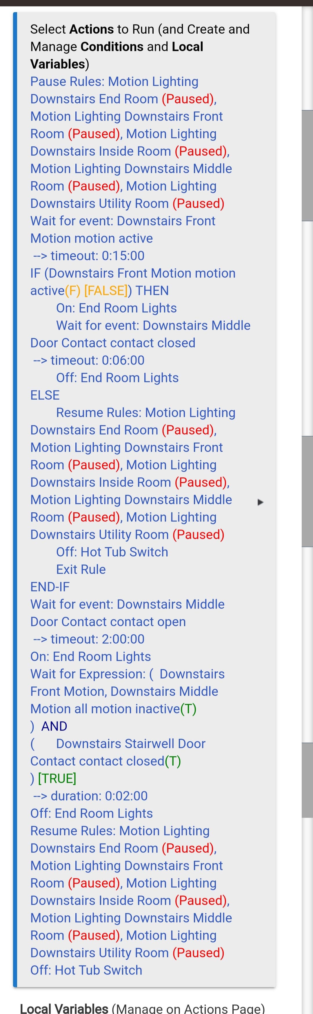

This may be basic but I haven't found it. The short version is, does a required expression turning false cancel a wait for event or wait for expression? I know retriggers or exiting a rule does, but my understanding was that (as long as the cancel pending checkbox was not checked), the required expression turning faults would not cancel a wait. I have several rules that have waits built in, but will no longer recognize the wait event if the required expression becomes false. Is this normal behavior?
Usually when this happens, the log will show/recognize that the wait event has been satisfied but will not advance the rule any further. It just stops. Even those wait events that have a timeout on them stop and don't advance any further.

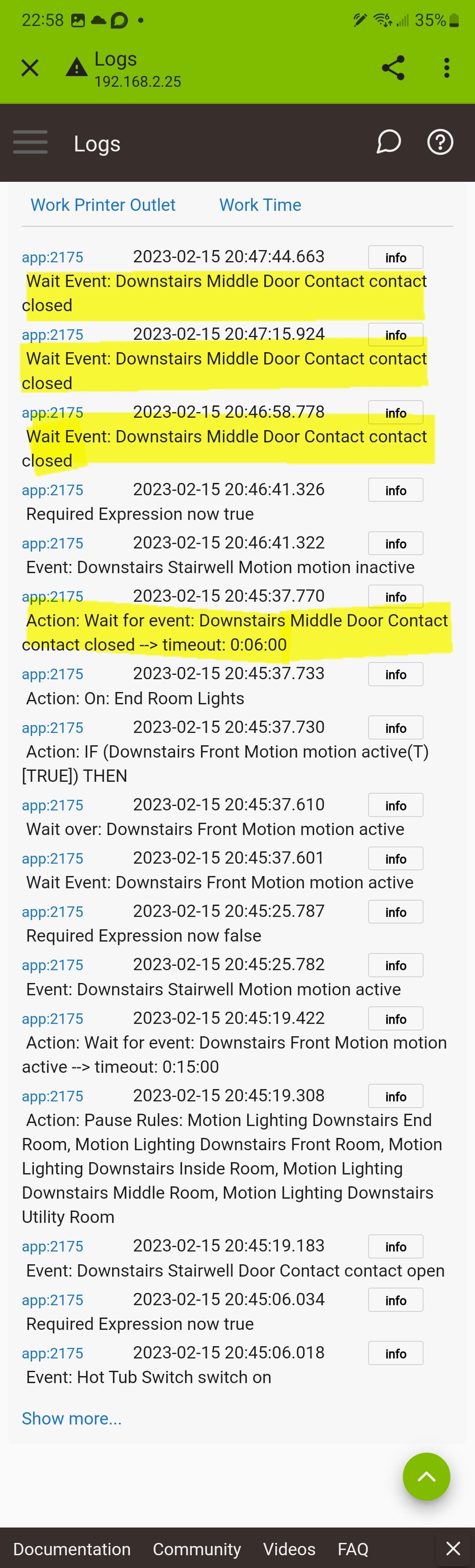

It always stops at the same place, on the wait for event, downstairs door closed. My first rule was hanging there and I tried everything I could think of (update rule, hitting done, editing, etc ). I finally deleted that rule and rebuilt it from scratch with a different required expression. This is the new rule and it does the same thing. It's waiting for the door to close and sees the door close, but doesn't advance. Tonight, I opened and closed the door three times trying to get it to advance the wait. It logged it three times but never moved forward. I just don't understand how it can wait for an event, see the event, and not logically pass it.

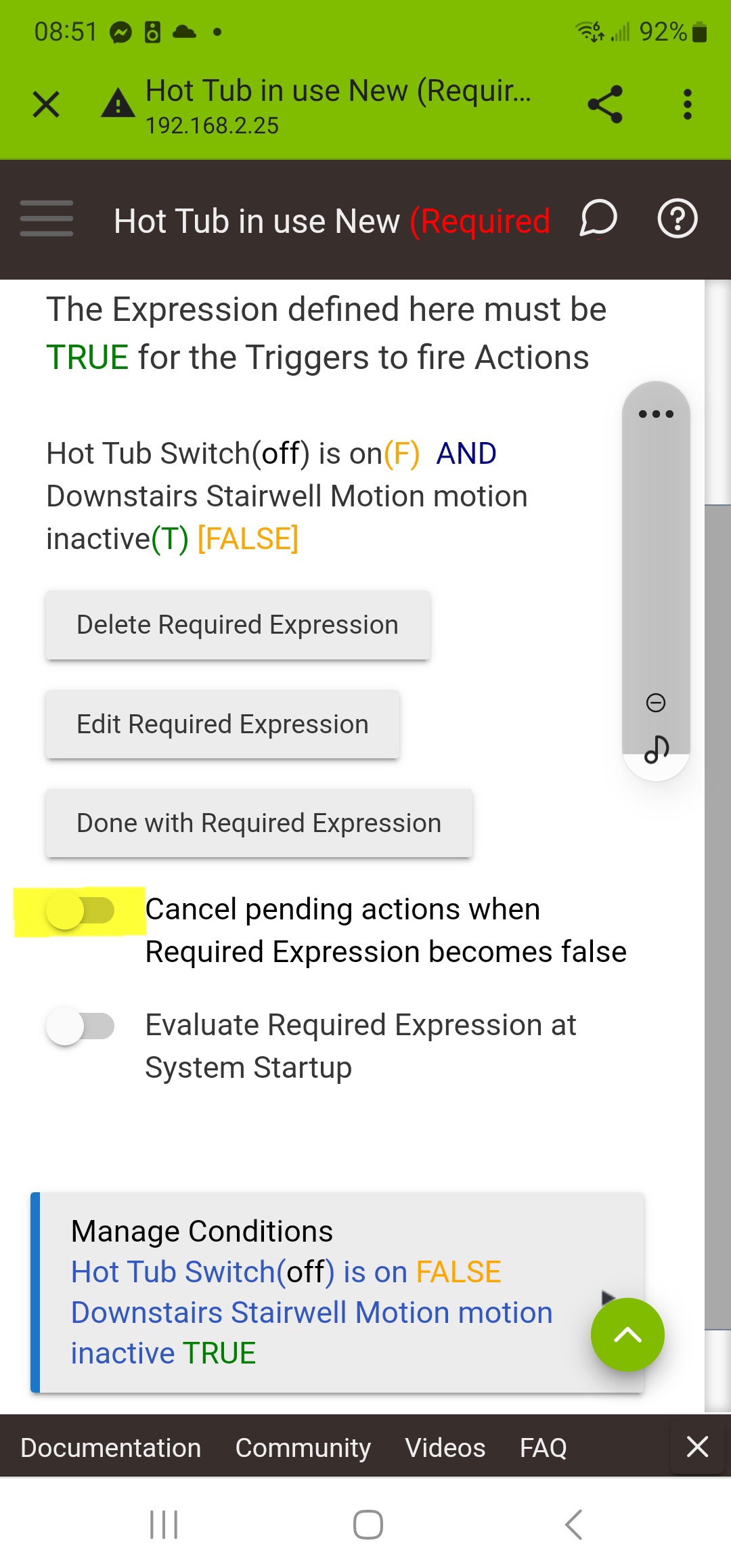

Here is the other screen shot just to make sure I didn't have it checked.
Any one see any reason this rule is stopping? I'm completely stuck and can't get this to work. I e rebuilt it three times with slightly different variations, re-initialized it, and rebooted the hub. The long wait seems to just fizzle out and I can't figure out why (other than the required expression turning false). I need the required expression though so that it only triggers under certain circumstances and doesn't cancel the waits.

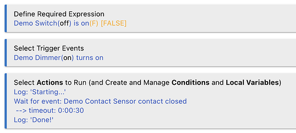

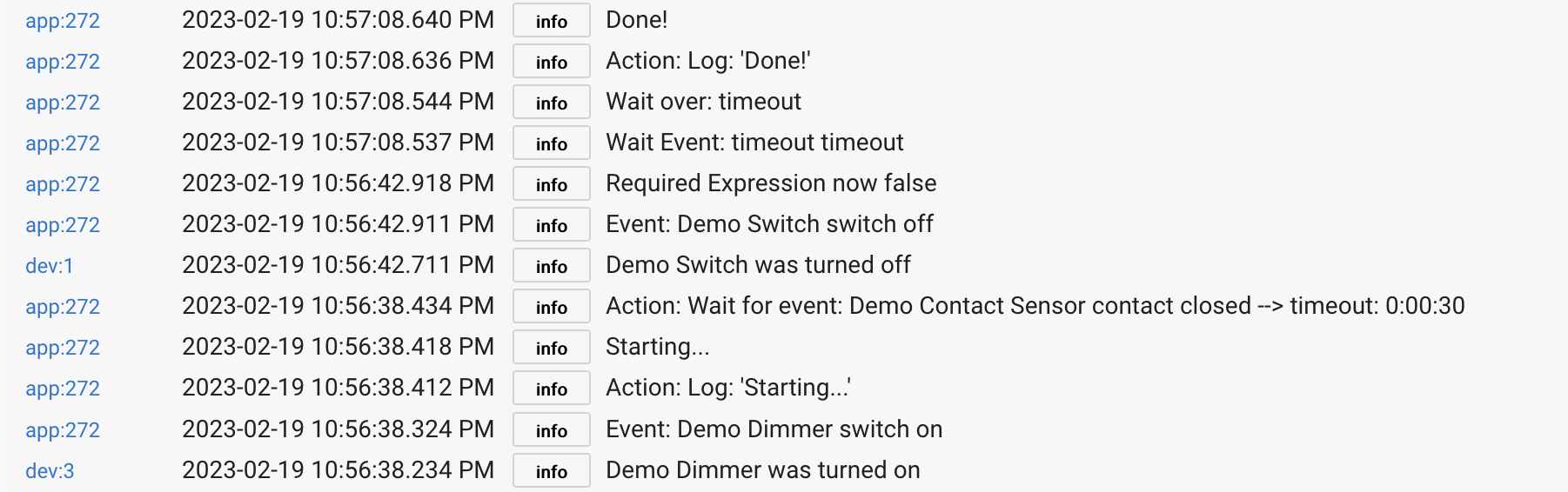

I'm not sure what to suggest other than that there don't appear to be any problems with this setup for me:
Logs:
This is true even though the required expression became false during the wait.

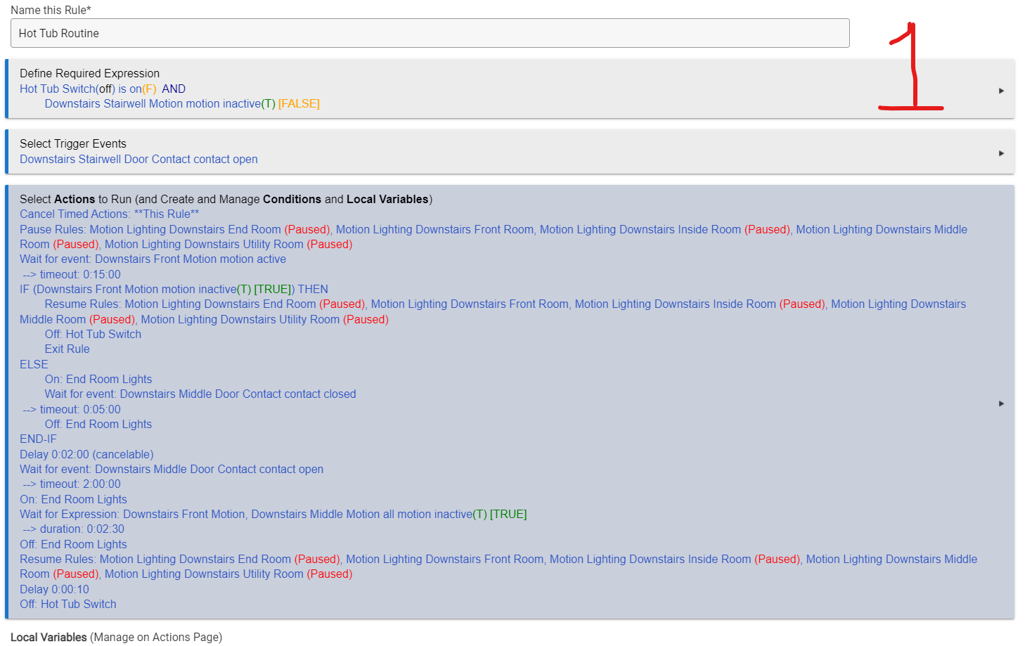

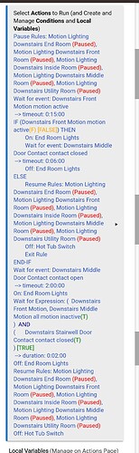

I 'think' the trigger and waits should not conflict, but I'm totally open to suggestions if there's something looping. Here's the complete rule (screenshot 1). I've rebuilt it four different times and deleted the old. This one has a cancel actions and a few delays that the others didn't have just because I was trying to vary it. I figured if the old didn't work, it couldn't hurt to give it some time between steps. Shouldn't matter, but it wasn't working the other way...

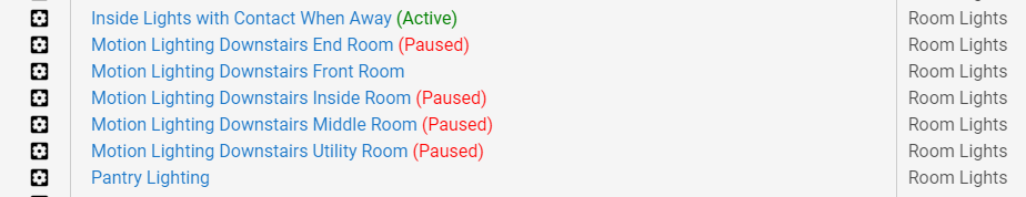

Is it possible that the hubs just wear out or something? Several rules seem to just stop working or don't complete. Others work most of the time, but then don't finish. My room lighting rules work about 95% of the time, but then you'll walk in one of the rooms and the motion will turn to active, but the light won't come on. In the logs, it will show it ran correctly and turned the light on and off. Last night, I ran an action to resume the paused rules (five rules) and it unpaused one of the five (see screenshot 2). Most of these rules were working 100% of the time a few months ago so the unreliability is confusing to me and seems to be getting worse.

As for your actual rule, I don't see anything there that looks problematic off hand, but the actions are also pretty complicated. I'd revisit this possibility:
I'll look at building the smaller/simpler parts of the rule and see how that goes. I thought about breaking it up into two, but that seemed counterproductive when it's all in one. The whole idea was that it retriggers under certain circumstances and cancels all the waits to re-run the rule, but not under other conditions.

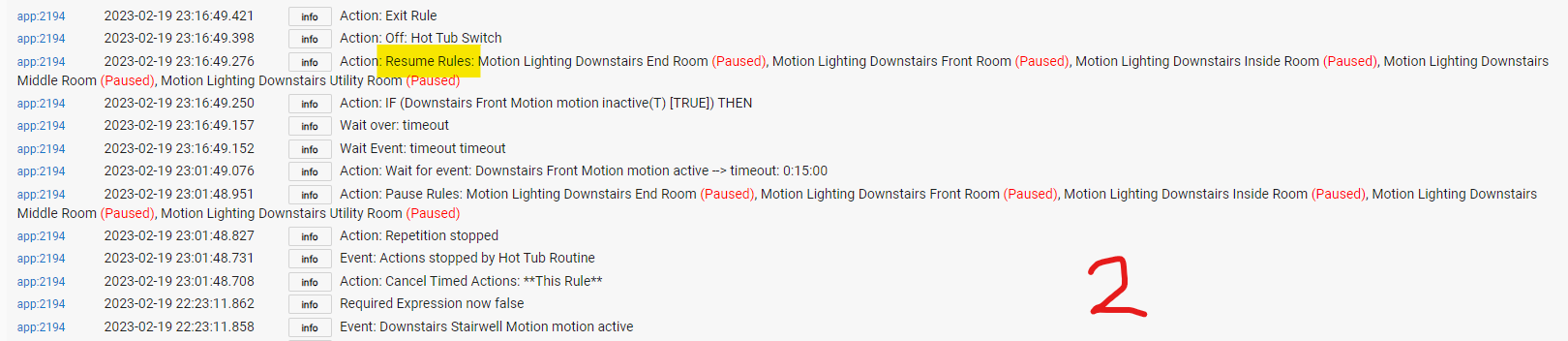

My thought with the hub wearing out was the pausing issue. It makes sense that devices don't always receive an action. But failing to un-pause a rule seems like an internal issue. Or in my case, a command with five rules to resume only completing one of the resume commands seems like the hub might be going bad (or something). The log says it un-paused all five, but only one was completed. Is that even possible?

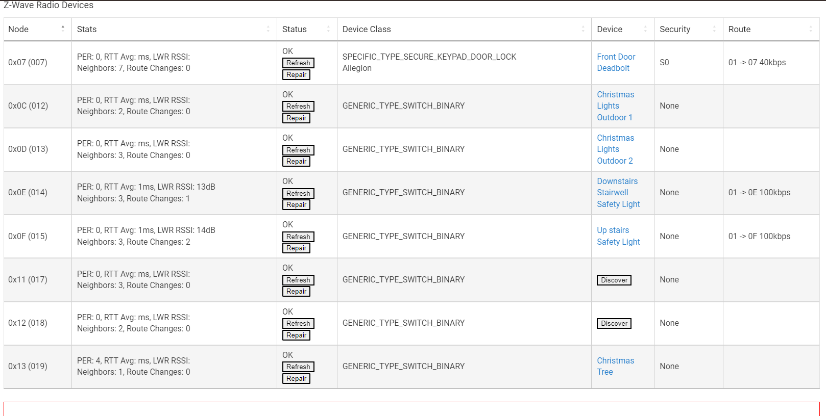

Would the network prevent resuming a rule? I don't mean to keep asking...I just want to understand so I can understand the solution fix. I was thinking that was an internal process that was not radio related. The lighting portion makes sense. I've posted the zwave page below.

  • There are Z-Wave issues, but not likely the cause of your broader problems. #17 & 18 look to be ghosts. They need to be removed as they will cause your Z-Wave devices to not perform well. You should exclude Z-Wave plugs if you are going to unplug them, for the same reasons. Some people get away with just unplugging, but excluding is "best practice"
