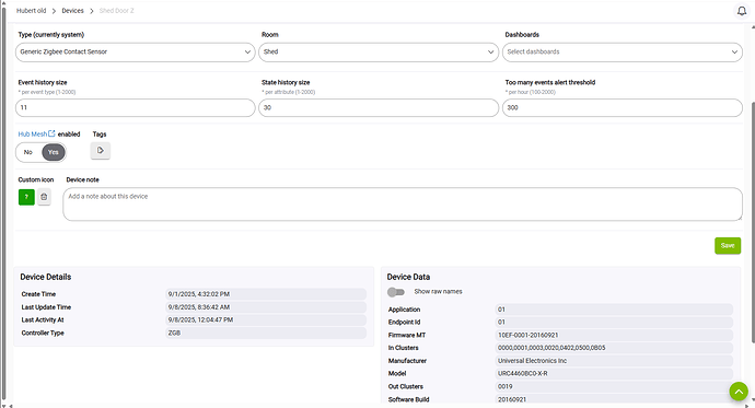

C7 with some zigbee and C8 with some zigbee, Zwave and all rules. Problem started when zse41 malfunctioned, was connected to C8 as the C7 has no zwave devices. Replaced it with a zigbee contact sensor, put it on the C7. Used device swap. Hub mesh shares it to my C8. No problems with any functions in the rules or anything except it has a scheduled job that shows on the C8 and gives an error every day around 1PM. Looking at scheduled jobs on the logs page on the C8 I only see my Zwave devices that have them, no zigbee. Have swapped to the device driver and cleared every thing but it still does it.

Are you sure the device ID matches? If you're looking at Past Logs in particular, you'll need to go by the ID (also works for live logs) and not the name. That is the device you should try looking at.
This is the hub-assigned device ID like you'll see in the URL, not the DNI or other device data.
ID's are matching. Also deleted scheduled jobs with device driver again. No luck yet. I will be replacing it with another zse41 when it arrives so should not have this problem then. I'm sure it's not a big deal but I have an OCD problem and don't know enough to fix it. Errors and Warnings drive me nuts.
