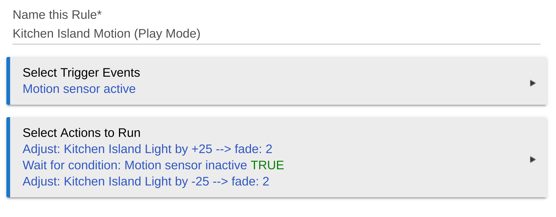

I'm creating a rule to slightly brighten the island light in our kitchen during a generally dark media watching scene.
the gist...
When motion on kitchen sensor is active
AND scene Play is active
THEN adjust Kitchen Island Dimmer +10
With Rule Machine, does it automate the opposite? (e.g. when no motion, adjust -10) or do I have to explicitly add that? Can it be in the same rule, or does it need to be a separate rule?

Thanks I’ll try the if changed

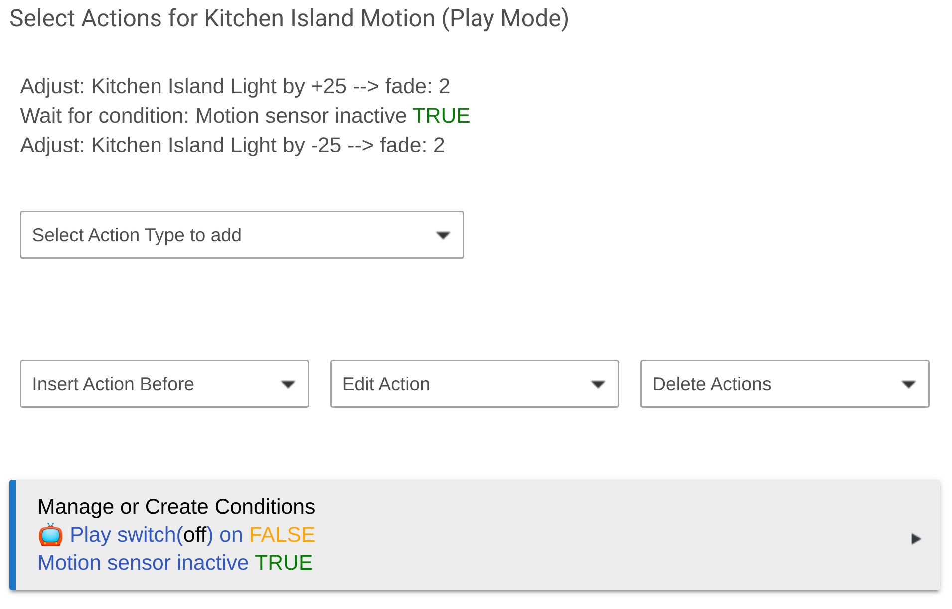

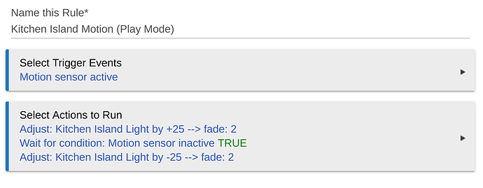

I couldn't figure out the if changed logic, so i tried the wait for event logic, we'll see if it works tonight.
It is recommended to use "Wait for events" over "Wait for condition". Please watch the last episode of Hubitat Live! - the logic is explained therein.
Noted and updated. fingers crossed.
