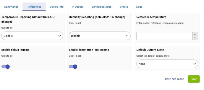

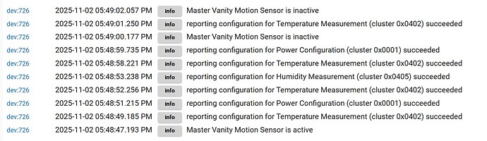

Here's a screen shot of the NYCE driver. Below that is the log file of a single active/inactive. If I change the drive to generic I don't see all that extra stuff.
I don't see any actual debug logging there, which is unusual if the setting is enabled (maybe hit "Save" just to make sure?). In any case, it does look like the device (driver) said it responded to the configuration, so if the data is still coming in, that leaves at least my one guess above as unlikely.

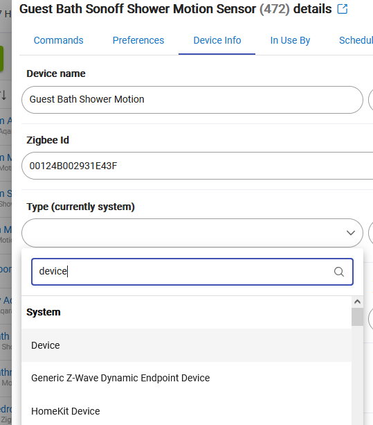

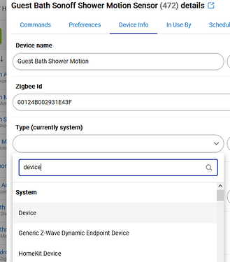

The solve is to blow all attributes. By changing the driver to 'Device' :dizzy_face:
then save it.

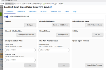

Go back into the device and now there are a number of buttons:
Mash all the buttons - one at a time.
Now click save once again.
Repeat the process and set the driver back to 'Generic Zigbee Motion (notemp)' or whatever it was. The attributes left are only the attributes of the active driver - no 'ghost' attributes remain. The HE community has been using this 'trick' for years to clear up some of these types of issues.
